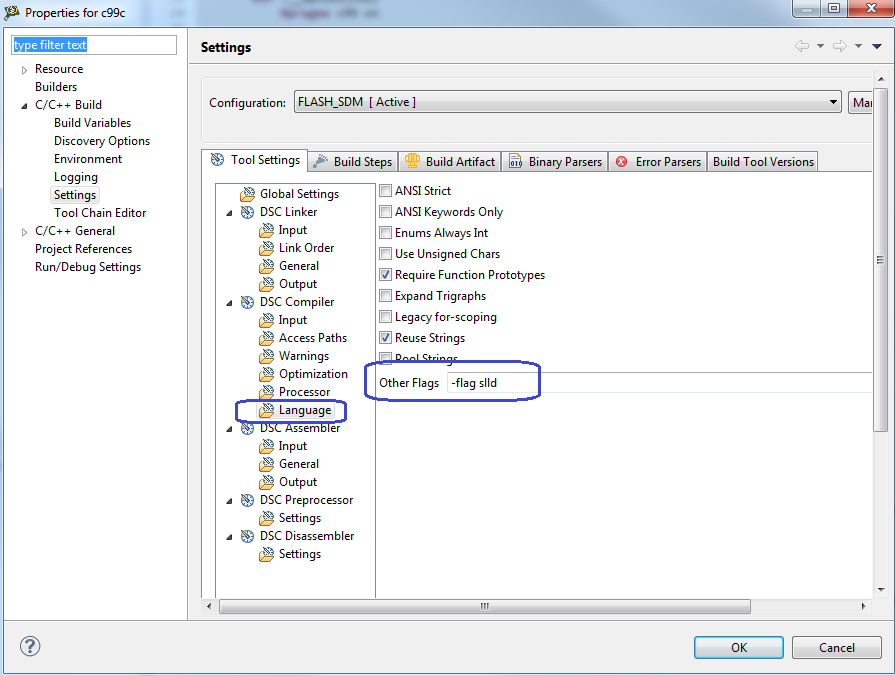

I want to use the _Bool type and `true`/`false` by including stdbool.h, here's my test code:
#pragma c99 on
#include <stdbool.h>
void main(void)
     _Bool b = true;
    b = false;
But I get the following error:  #warning "MSL support for C99 is not enabled"
And neither `true` or `false` is defined. `_Bool` is defined and works correctly so I'm confused as to what's happening. How do I enable C99 mode, get the correct defines and get rid of the warning?
I know that, since _Bool works correctly, I can just define `true` and `false` myself but I want to understand what the warning means and what other problems it may cause.
I'm using CodeWarrior 10.6 build 140329

TICS_Fiona
Hello Colin
Please add the compiler option –flag slld to remove this compiler warning.
To add the option, pleases select ‘Project’ menu ->Poperties > C/C++Build > Settings > DSC Compiler > ‘Language’ Panel >Other Flags
Best Regards
Fiona Kuang
Technical Information & Commercial Support
