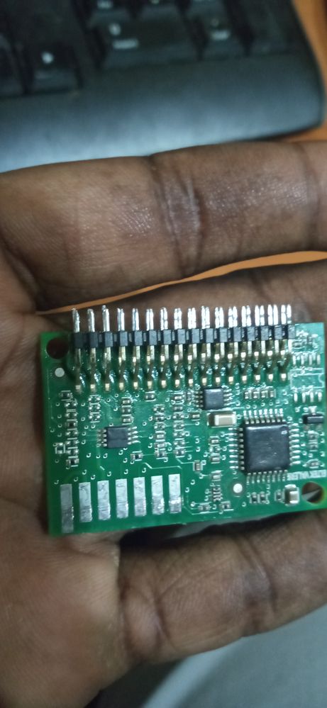

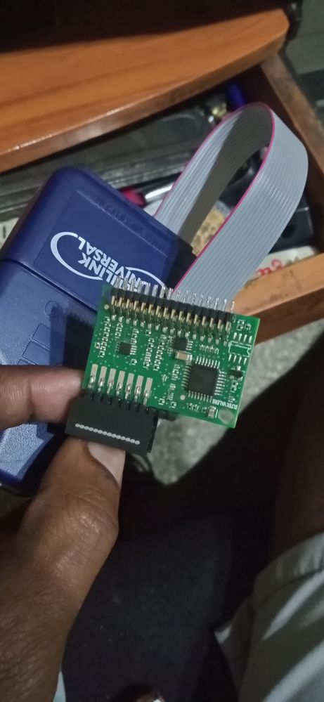

mademusa

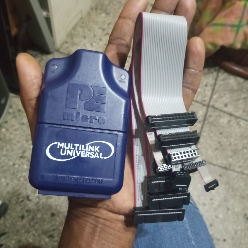

Hello, I just got the product you have recommended me!
The USB Multilink Universal.
To my surprise, none of the connectors matches the board I intend to flash.
I had sent you the pictures before, so I thought one of the cables would match.
Do I have to solder pins to the board to use the 7 pins connector? what would be de possition of the pins?

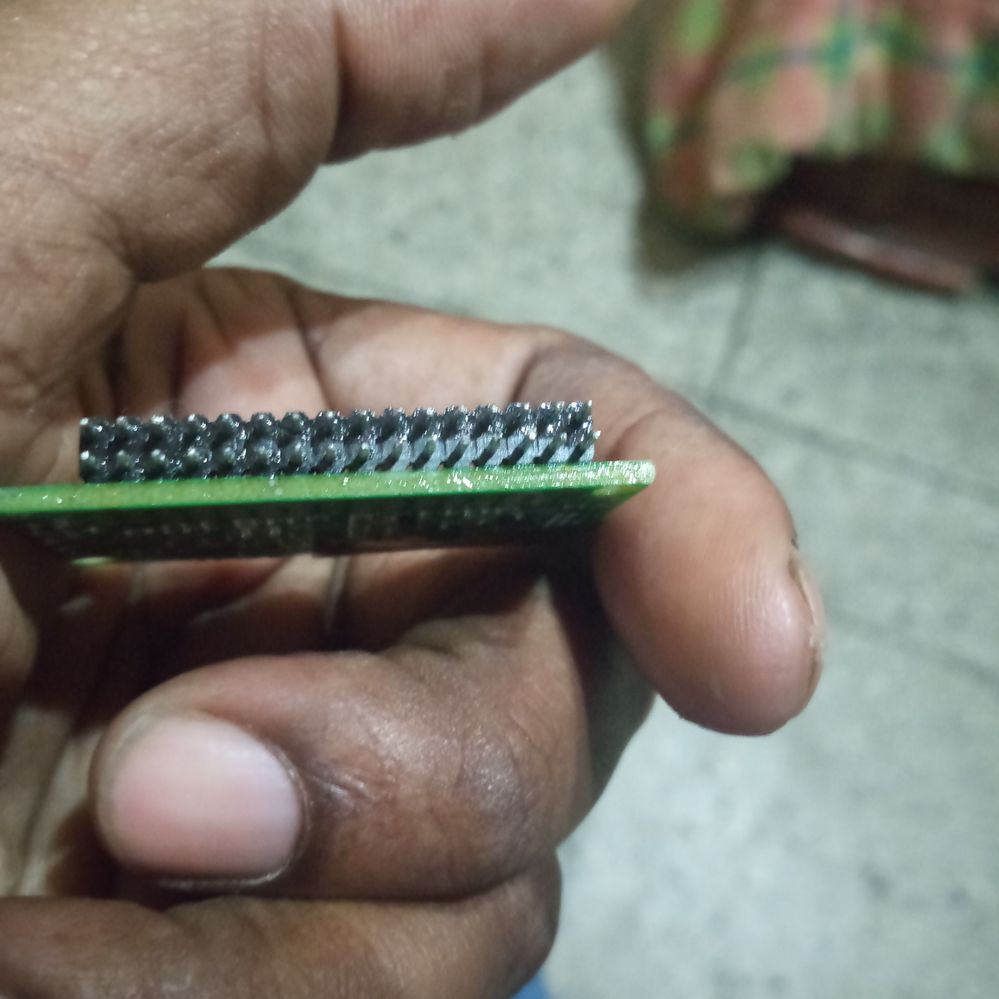

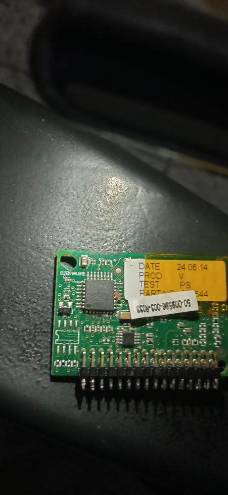

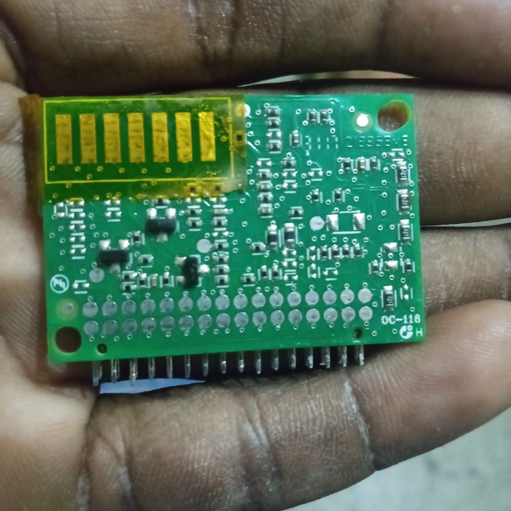

mademusa
Thank you for your patience!
The chip number is exacly MC56F8014
I could not get a clear picture, but i can assure you it´s MC56F8014.
If you look at the pictures you can confirm the chip number.

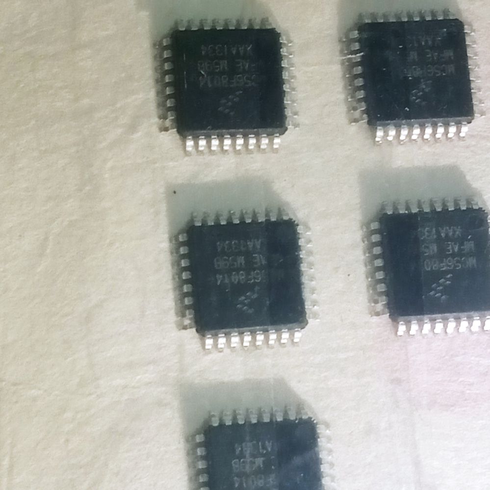

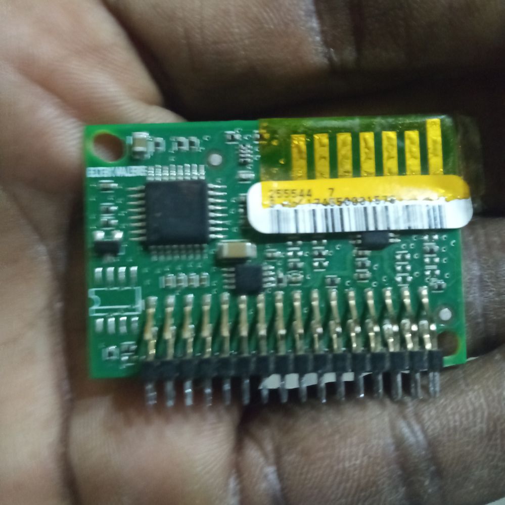

Also since none the cables seemed to match the board, I remove the plastic cover on one of the sides and saw a series of pins that match the number of pins from one of the cables, so i made a adapter myselft, one of the pins on the board is visibly larger the the other ones, so I assumed it`s for the red wire. I have not run any test because I want to wait for your answer to see if its possible.
Original BoardOriginal BoardOncovered pins, the one on the left is longer than the other onesOncovered pins, the one on the left is longer than the other onesChip Close UpChip Close UpAdapter I CreatedAdapter I Created

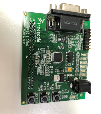

xiangjun_rong
This is the picture of the Freescale MC56F8014 Demo board, obviously, it is different from yours.
For your board, I have not your board schematics, pls find out the JTAG pin, and connect with your Multilink Universal device.

mademusa
Ok, i got it all wrong from the begennig then.
My board is not a demostration board. It`s a board taken from an ELTEK industrial power supply. I repair this kind of power supplies. Now, I have many power supplies of this kind with what I suspect is corrupted MC56F8014 that causes de power supply to work erratically, I know this, because if I swap the board containing the MC56F8014 with the same board on a working power supply, the problems gets solved in the first one and the other one gets the errors.
What I want to be able to do is to extract the software in the chip MC56F8014 on a working board, and write it to an empy chip.
I am not trying to write a new program or anything like that, just reflash the corrupted chips or flash new chips and solder them into the boards.
