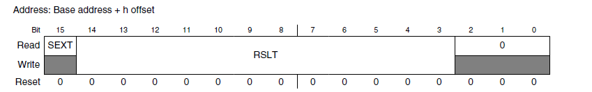

It seems that your issue is different with the issue of Douglas, you observe that all channels have the 20 LSB noise issue, for the case, pls check the ADC_RESULT register format:
As you can see that the 3 low bit are always 0, if you connect AGND to analog channel, the ADC12_RSLTx is 20 LSB, the actual lsb is about 2~3 bits(20>>3), the noise is about 3mV, i think it is okay. If it is not your case, pls check the ADC driving clock, which must be less than 20MHz.

Xiangjun,
The 20 counts in the ADC was already considering the shift that you talked about above.

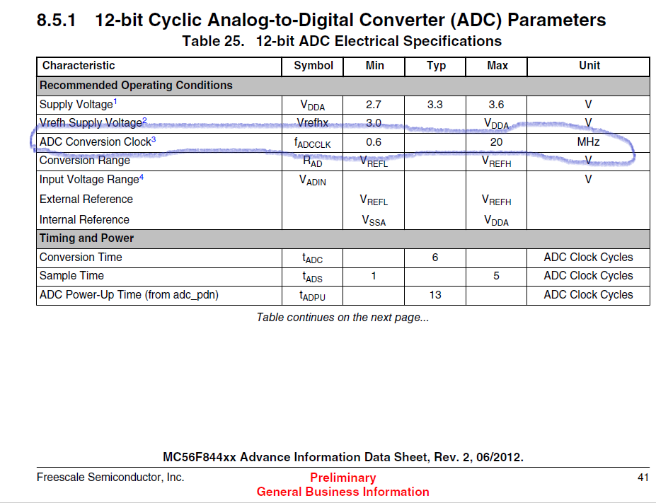

Where did you find the information about the ADC driving clock having to be less than 20 MHz?

Hi, Plinio,
Pls refer to the section 8.5.1 in data sheet of MC56F844xx.
