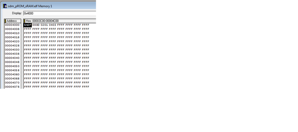

Recently we have  started to try to use the data flash to hold various sytem settings. I'm not having any success at getting the routines to write to flash.
The flash is located at 0x4000, but the routines require the address to be x2, along with the source address and the block size (unless I am mis-reading the documentation!)
'F' is the name of the source data area which is to be written to flash, and 'CopyForWrite() is a function to copy the data into the 'F' buffer from elsewhere.
My code for writing is as follows:-

If I look at the return value (rv) from the IFSH1_SetBlockFlash() function, it is set to 8, which I checked is
ERR_BUSY8Device is busy
How do I get my data written to the Data-flash?

Its your choice if you want to use word or byte addressing.  I'll show you both.  Which one is in force depends on the Processor Expert routines that you pick.
Here is the sample code:
void main(void)
  /* Write your local variable definition here */
  /*** Processor Expert internal initialization. DON'T REMOVE THIS CODE!!! ***/
  PE_low_level_init();
  /*** End of Processor Expert internal initialization.                    ***/
  /* Write your code here */
  // write badf000d to data flash using word at a time method:
  IFsh1_SetGlobalProtection(FALSE);  // unprotect the data flash (see PEx properties IFsh1).
  IFsh1_EraseFlash(0) ;              // there is only one data flash block to chose from
  IFsh1_SetWordFlash(0x4001, 0x000d); // write badf000d to flash a word at a time
  IFsh1_SetWordFlash(0x4000, 0xbadf); // using word addresses
  //write 01020304 to data flash using byte at a time method:
  IFsh1_SetByteFlash(0x8004, 0x01);
  IFsh1_SetByteFlash(0x8005, 0x02);
  IFsh1_SetByteFlash(0x8006, 0x03);
  IFsh1_SetByteFlash(0x8007, 0x04);
  // Note, 8004 byte address is like the 4002 word address, but 8004 byte address
  // only addresses a byte.
  for(;;) {}
And the results are as follows after running code as observed with CodeWarrior 8.3 for DSC (best choice of tool for this family of devices):
