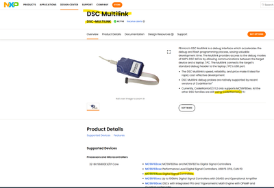

I actually see/find this DSC Multilink DSC-MULTILINK -
https://www.nxp.com/design/design-center/development-boards-and-designs/analog-toolbox/dsc-multilink...
It appears under the CodeWarrior® for MCUs (Eclipse IDE) - ColdFire®, 56800/E DSC, Qorivva® 56xx, RS08/S08, S12Z - 11.1 CW-MCU10-
https://www.nxp.com/design/design-center/software/development-software/codewarrior-development-tools....
and DSC Multilink DSC-MULTILINK shows to support DSC MC56F84xxx-
So, Do you think
can recognize
and work together to program/download firmware to MC56F84763VLH?

Celeste_Liu
Hi cyang,
The DSC-MULTILINK is a kind of debug probes. Similar to Jlink, it has to be used on a PCB board instead of being directly used with a mcu chip. If you want to use it, you need to have at least an evaluation board or a custom board.
Hope it can help you.
Celeste

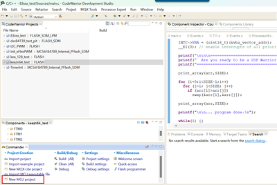

I am trying to follow the instruction you provided
https://community.nxp.com/t5/Digital-Signal-Controllers/Program-DSC-with-CodeWarrior-for-MCU-ver11-x...

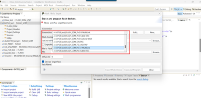

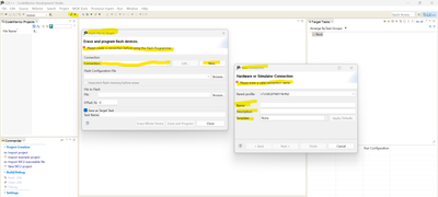

But, in the instruction, in section "2) Launch the programmer", it doesn't show how to configure to show and add the Connection device and where/how to get/add the Flash Configuration File i.e. *.xml -
Can you provide me the step by step instruction how to add/configure the following -

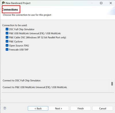

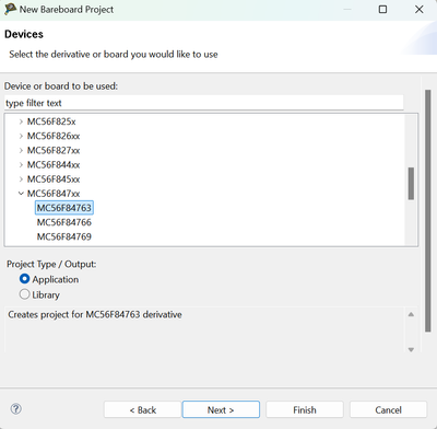

Celeste_Liu
Hello @cyang09 ,

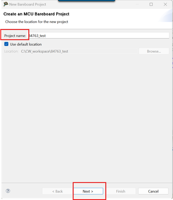

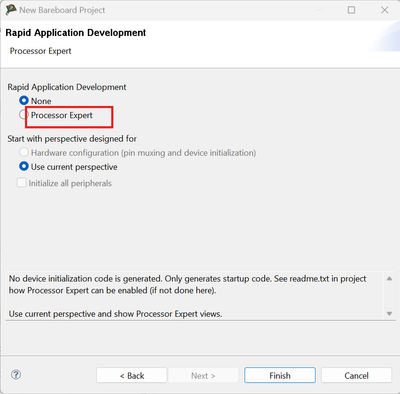

The connection device and the flash configuration file, namely *.xml, depend on the project setting. For example, the simplest way is to create a new MCU project.
1. Click "New MCU project" button:
2. Fill in the project name and click "Next".
3. Select the device you use, such as MC56F84763. Click "Next" button.
4. The selection interface of "connections" will appear. You can select multiple options according to your needs. Then click "Next".
5. On the "Rapid Application Development" page, you can also choose whether to use Processor Expert. Regarding Processor Expert, you can obtain more knowledge via the Processor Expert introduction - NXP Community
After completing the above operations, click the "Flash Programmer" button again. In the connection option, you can see the following options based on your previous selection. After selecting the connection, the Flash Configuration File will automatically display the MC56F84763.xml file.

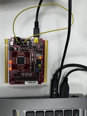

Celeste_Liu
Hi cyang,
Thanks for your post. The CodeWarrior Development Studio offers support to the MC56F84763VLH. The relevant download link is as follows:
CodeWarrior® for Microcontrollers-Eclipse IDE 11.1 | NXP Semiconductors
As for the firmware downloading cable/interface, you can use USB cable to connect the board and PC, as the following picture:

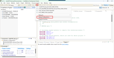

Then, explain how to use CodeWarrior Development Studio to program.
1. Open Debug Configurations
2.  Select the required project with the suffix "OSJTAG".
Besides, there is also a debugger, the USB TAP.

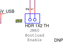

MCF5684763 might encounter issues when used on Windows 10/11. It is necessary to update the firmware on a Windows 7 PC. First, short J17 and connect it to the PC via USB. Then the IDE will detect it and a prompt for updating the firmware will pop up.

cyang09

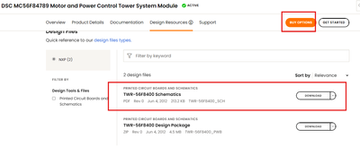

May I ask what might be the board you are showing in the picture?
Where can I get it and is there any schematic for it?
By the way, you mentioned the "USB TAP for ONCE DSC", but does it support the MC56F84763VLH?
In https://www.nxp.com/products/processors-and-microcontrollers/additional-mpu-mcus-architectures/digit....
, it doesn't show supporting the MC56F84763VLH family.

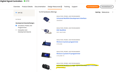

And, do you know whether the CodeWarrior® for Microcontrollers-Eclipse IDE 11.1 | NXP Semiconductors support using any of the following programmer cable to load/program the firmware to MC56F84763VLH?
Chien
9,450件の閲覧回数
Celeste_Liu
Hello cyang,
Let me answer your questions one by one:
The summary page of 56F84xxx chip: MC56F84xxx | Performance-level Digital Signal Controllers | NXP Semiconductors
1. What is shown in the picture is the Tower board of 54F84xxx chip, named TWR-56F8400.
2. The summary page of TWR-56F8400: DSC MC56F84789 Motor and Power Control Module | NXP Semiconductors
The purchase link and schematics can be found on this web page.
3. Yes, the USB TAP for ONCE can be used on TWR-56F8400, but not on a single MC56F84763VLH chip.
4. The programmer in the picture can be used with CodeWarrior to program the firmware to the MC56F84763VLH chip. They are from P&E Company, as shown in the following picture:
If you have any questions about choosing a programmer, you can contact P&E support.
