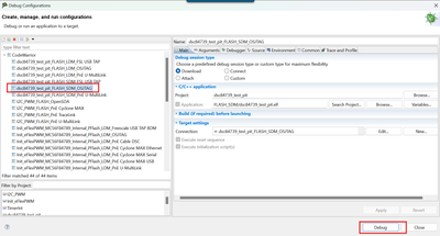

As for the firmware downloading cable/interface, you can use USB cable to connect the board and PC, as the following picture:
Then, explain how to use CodeWarrior Development Studio to program.
1. Open Debug Configurations
2.  Select the required project with the suffix "OSJTAG".
Besides, there is also a debugger, the USB TAP.
USB TAP for ONCE DSC | NXP Semiconductors
If you have this, the difference is select the required project with the suffix "USB TAP".

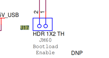

MCF5684763 might encounter issues when used on Windows 10/11. It is necessary to update the firmware on a Windows 7 PC. First, short J17 and connect it to the PC via USB. Then the IDE will detect it and a prompt for updating the firmware will pop up.
