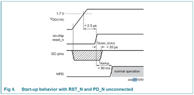

Does it have anything to do with the 90ms period from when RST_N and PD_N become High until HPD is output?

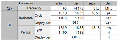

LCD Timing characteristics

Q2 Is it okay to set the MsBus at any time?
[r]PTN3460I I2C pins are not failsafe and cannot be connected to the SMBus if the
SMBus has active communications during VDD33 supply switch ON. In the application
there MUST be no MS_I2C traffic during supply rise-up

"during VDD33 supply switch ON" is the recognition after tstsrtup.
When communication was performed from SMBus after this period, it was possible to write to the register and it could be recognized by the Host PC at 1920x1080 pixels.
However, the liquid crystal has not been able to display anything yet.
When I checked the EDID reading result of the HostPC, the contents of the default EDID No. 4 were read normally.
Does this mean that EDID No 4 does not match the EDID required for my LCD?
Or is it because there is something missing in the settings in the configuration register?

Firstly I think you need confirm your LCD suit for EDID4 configuration(1920 x 1080 @60Hz) or not.

Revised the LCD timing Power On sequence.
