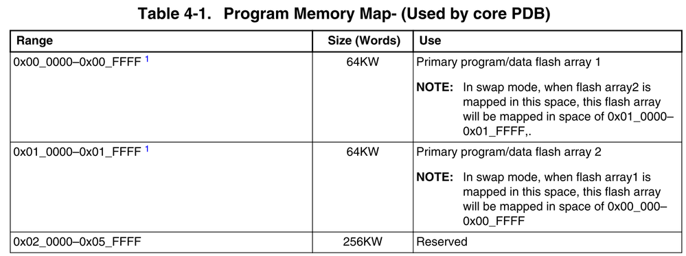

The MC56F83xxx has two flash data block as RM show.
So my application is run in primary flash array 1. and use primary flash array 2 for my save data area.

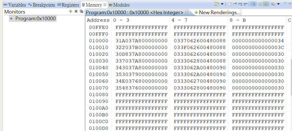

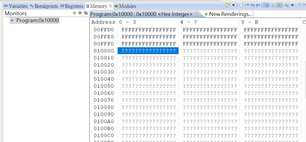

but I can't check the flash array 2 data states in Codewarrior debug mode. Like below picture.
It's all show "????"
I am pretty sure I have the Data written into Flash array 2.
Because I change the project of part number to "MC56F83789" and it can show my save data states.
Only when the project is set to MC56F83783, the data flash array 2 information cannot be read.
It can easily reproduce this problem on EVB.

Our AE team has tested your project, because the MC56F83763 has only 128K Bytes flash or 64K word(16 bits) flash, which are from P:0x0000 to P:0xFFFF, so all the memory from P:0x10000 are empty
That is why all the data from P:0x10000 are ?????????????

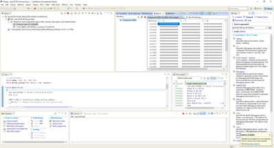

Please use attached file to entry debug mode then then check flash memory map.
Thanks.

I have tried on my FRDM-56F83000 board on which the MC56F83789 is integrated, as your result, I can see the memory contents from P:0x10000.

You don't need use MC56F83783 to duplicate this issue.
Just only need select "MC56F83783" when creating a project and use this project to program FRDM-56F83000 board, then check the information of P:0x10000.

I have created a project based on MC56F83783, and run it on MC56F83789, I can see the P:0x10000, no problem.
