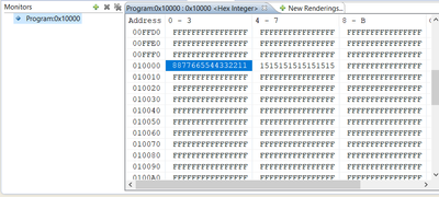

zivn
I managed to successfully write to the flash. I can program bytes in to address 0x20000, and then I can see the data in flash in address 0x10000 but only if I look at the address as program and not as data
My question is, how do I access this data from the code ?

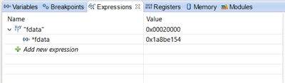

I tried a few things but keep getting the wrong data:
uint8_t *fdata[8];
*fdata = (uint8_t *)(0x20000);
OR
uint32_t *fdata;
fdata = (uint32_t *)(0x20000);
I get the wrong data in fdata, although the address is 0x20000
How do I read the data from the flash correctly ?

xiangjun_rong
If you want to read program flash, I suppose that there are two methods:
1)using the api function defined in the AN1952.pdf
https://www.nxp.com.cn/docs/en/application-note/AN1952.pdf
But the AN is based on DSP56800 core, now the MC56F83xxx uses DSP56800EX core, you have to modify the api function.
2)The program address in program domain is also mapped to data address in data domain, pls checked the data sheet and get the address in data domain.For example,
P:0x0_0000~0x1_FFFF is mapped to the data memory X:2_0000~3_FFFF, so you can read the X:3_0000 to get the data in P:0x1_0000.
Hope it can help you
XiangJun Rong

zivn
Thanks, this solved the problem
