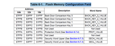

xiangjun_rong
Hi,Ganesh,
Pls refer to section 6.4 Memory Map in the MC56F8000RM.pdf, especially Table 6-1. Flash Memory Configuration Field.
you can write Flash Memory Configuration Field to set up the Flash security mode, when the SECL_VALUE is equal to 0xE70A, the flash will be in security state, the JTAG port will be blocked. You can not read anything from JTAG port.
But you can execute the mass-erase instruction in security mode via JTAG port, which will erase all flash data, you can reprogram your own application code via JTAG port.
Hope it can help you
