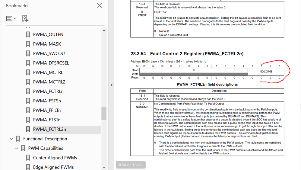

mohammad_kamil
Hello Chao Zhuang, can you please share screenshot of RM for "NOCOMB bit in register PWMA_FCTRL2n" where it is in MC56F847XXRM. As i dont see this register  and bits in RM.
4,965 Views
chaozhuang-b500
