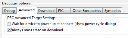

I'm using MC56F84789, CW 11.0.1 and trying to download An4759sw.

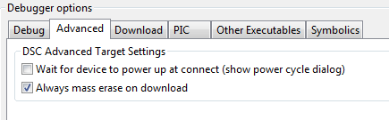

Whenever "Always mass erase on download" checkbox is set:

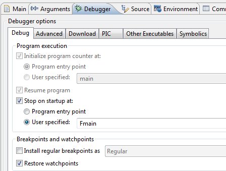

After download, code execution stops @  user specified "void main(void)" function which is expected. Debugger options configured as follows:

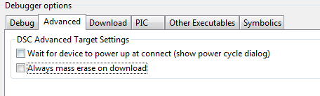

However when "Always mass erase on download" checkbox is cleared then after download, code execution stops @ _EntryPoint() as shown below:
Can someone please explain why if debugger options were the same in both cases?

If you check the "Always mass erase on download" box and check the "User specified->Fmain", the debugger works as you expected.
If you UNCHECK the "Always mass erase on download" box and check the "User specified->Fmain", the debugger selects "Wait for device to power up at connect" I think, in the case, the scenario is you will power-down and power-up, in the case, it does not matter whether the PC points to _EntryPoint() which is the first instruction your DSC executes or Fmain() which is the first instruction the User code is executed.
Why debugger would select "Wait for device to power up at connect" if respective check box is not selected?
Can you please try downloading of any code, for example An4759sw, using these two options and let me know?
1/ Using this option debugger stops @ main.
2/ Using this option debugger stops @ _EntryPoint().

I have tried to download code with unchecking both  "Always mass erase on download" box and "Wait for device to power up at connect" box,select  the "User specified->Fmain" , the PC pointer always stays to Fmain instead of entry_point.
I use  - CodeWarrior for MCU
     Version: 11.0
     Build Id:170926
It maybe has the other reason.
