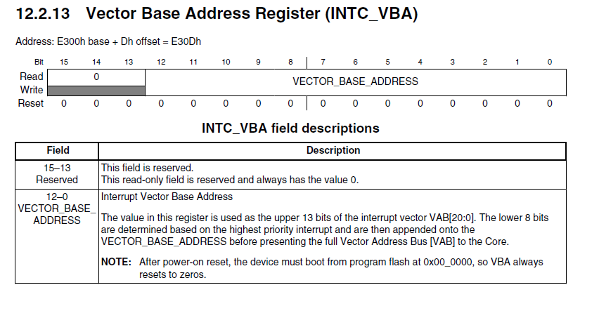

I want to remove my bootloader so I can only upload the firmware using JTAG.
This means that when I power up, it should driectly run the application code.
How can I move up the application code to address 0000? Is there something I need to change in IDE settings or in build files?

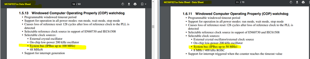

fasihahmed
can you explain the difference in flash speed between these two DSCs?
will the MC56F83763 provide better performance compared to MC56f82748 if we run the code in FLASH? I ask this because there is difference in both the DSC's internal clock frequency? 50Mhz vs 100Mhz
And will running MC56F83763 code in FLASH v/s RAM provide any speed difference? I know it helps for MC56f82748.  But not sure about the new MC56F83763

xiangjun_rong
Hi, Fasih,
Regarding your question, even if you have bootloader code in flash, after you download your application code to flash, and the Reset vector points to your application code, after Reset, only your application code is executed.
If you do want to remove your bootloader code, you can execute mass erase, which erase all flash.

xiangjun_rong
Hi, Fasih,
Pls refer to the following Figure, you can write the INTC_VBA to relocate the vector table.
