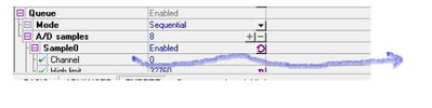

Hi I am using MC56F8014 DSC, I have encountered with warning while configuring ADC, i am using 7 ADC channel out of 8 channel,screenshot attached, kindly suggest fix

Hi, Aditya,
Regarding the warning, I think you do not use the channel in SAMPLE[x], as you know that each sample[x] corresponds one channel, if you use all 7 channels, you have to add 7 SAMPLE[x], for example, SAMPLE[0], SAMPLE[1], SAMPLE[2], SAMPLE[3],...SAMPLE[7].
you can select for example,
SAMPLE[0] use channel 0
SAMPLE[1] use channel 1
SAMPLE[2] use channel 3
SAMPLE[3] use channel 2
SAMPLE[4] use channel 4
SAMPLE[5] use channel 5
SAMPLE[6] use channel 6
SAMPLE[7] use channel 7
Pls have a try.
Hope it can help you
XiangJun Rong
