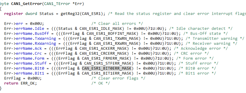

if CAN send data,but don't have a receive,now the code can't  run normal. My question is what can i do

I don't know how to use "byte CAN1_GetError(CAN1_TError *Err)", can you gave me a demo code, thanks!

MC56F84763,when start, send data
but, if don't have a receiver, it while into:void CAN1_InterruptTxWarning(void),   and not into "while(1)".
last, i didn't find a demo code
my english is so poor,  please, gave me a help about my question.
THANKS!
