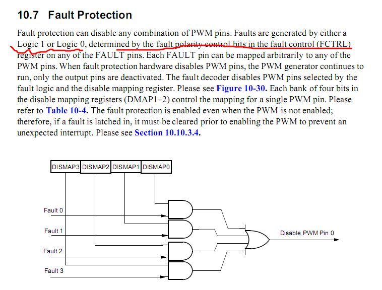

Dear all,
I am using the fault protection of 8013, the Manual book writes" Faults are generated by either a Logic 1 or Logic 0, determined by the fault polarity control bits in the fault control (FCTRL) register on any of the FAULT pins. " However I can't find control bit in the FCTRL. I wonder that if the 8013 support different logic level,especially the logic 0? Thanks a lot!

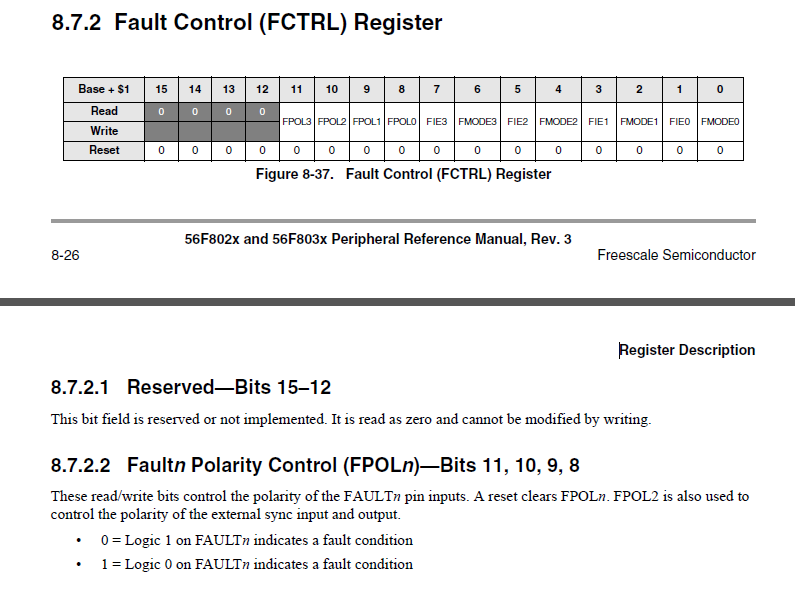

I do not test whether you can set up the Fault pin logic for MC56F8013,it seems that the RM oF MC56F8013 has not the polarity setting bits. Anyway, I copy the part from RM of MC56F8037 which has the FPOLx bits to set the fault pin logic.
pls have a test on MC56F8013.
