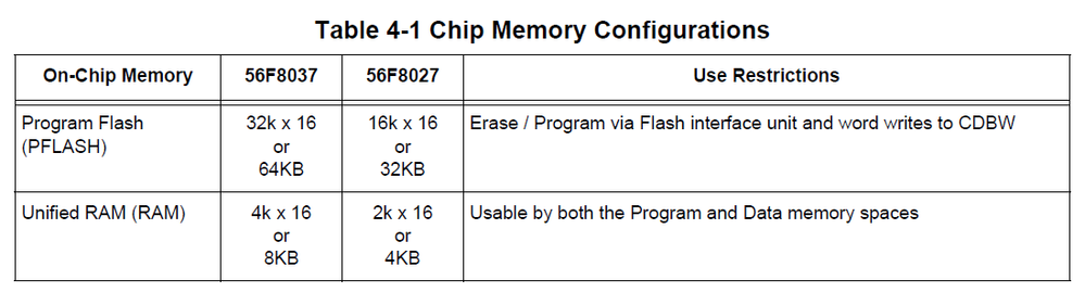

Let me clarify, as you know that the MC56F803x includes MC56F8027 and MC56F8037, they have different flash size and SRAM size. Both the MC56F8027 and MC56F8037 have only program flash, they do not have data flash, but the constant data can be saved in program flash.
MC56F8037 has 64KB program flash and 8KB SRAM, the MC56F8027 has 32KB program flash and 4KB SRAM.
I copy it from data sheet of MC56F8037.
The page size is 512Byte for both 8037 and 8027.
Hope it can help you
Xiangjun Rong
