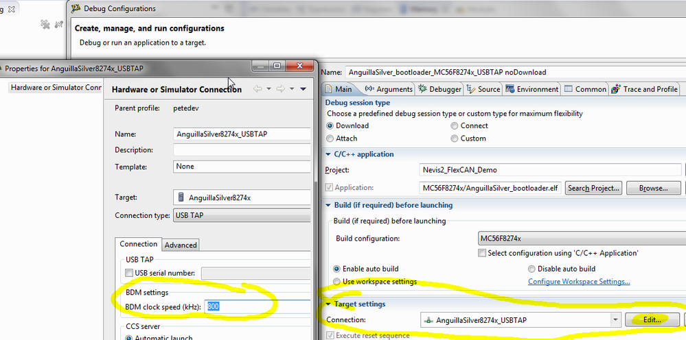

I am trying to remote programming the MCU 56F8037.
1,492 Views
dynapb
Hi Alon
Is it the ribbon cable that you are extending?
Can you give more details on the problem?
What happens when you try to program?
Some things to try:
  1. Try shielded ribbon cable.  Probably with shield grounded only at your target DSC board.
  2. Slow down the programming speed of the USB TAP as shown in the screenshot.  Maybe try 500 or keep going down until it is reliable.DebugConfig_USBTAP-Properties.png
