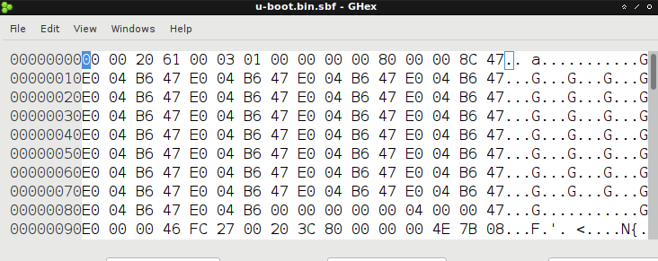

Hi all,
i am trying booting u-boot using SBF and a SPI NOR flash. I am actually flashing the spi NOR with a small tool i did running from sram.
So, i program the SPI NOR with an u-boot (derived from the fsl TWR system, so same start.S) but prepending the binary with the 7 bytes of sbf header just before.
So from the above SBF header i would boot just a chunk of 32k. I see by scope 32k of data read from the SPI NOR correctly.
Btw, no code seems executed just after this load.
Is it possible this is due to some incorrect SBF_RCON setup ?
I have a 30Mhz crystal so if anyone have a sbf header i can test, as proven to work, that's welcome.
Many thanks,
angelo

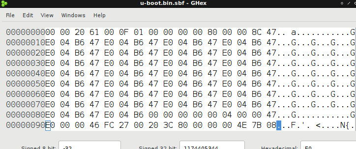

SOLVED.
Ok i try to explain what happen, if some day some other developer pass from here with a similar issue.
1) as Tom explained, SBF header CODE LENGTH (2 bytes) and SBF_RCON header (4 bytes), for mcf5441X,
must be written "little endian" into the SPI NOR. Strange but true :smileyhappy:
2) as Tom explained, another important thing is to set a quite low clock setup in SBF_RCON fields, or a too high clock (not supported from spi nor) screw up the program loading.
3) rest of the code can be written "as is", as produced from the compiler, so addresses are "big endian"
4) note that length must be in longwords and total code must not exceed 64KB of internal SRAM or the code in excess is anyway read and probably wrapped around that limit back to 0x80000000 screwing up the boot.
I paste here below a working sbf header for mcf54415 and a 30Mhz crytal, tested by a square wave on gpios.
still many thanks Tom,
regards,
angelo
