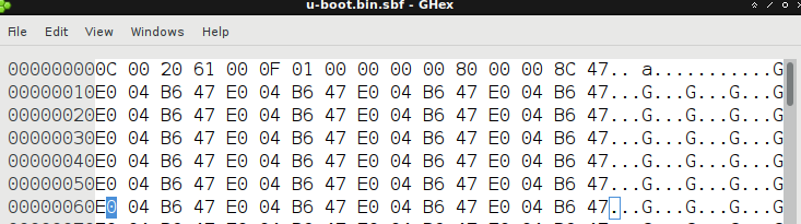

I solved this too, and i am now at u-boot prompt :smileyhappy:
My issue was related to DDR2, as you pointed out, but maybe on a special case, so i found out an interesting thing:
1) DDR2 cannot work from specification below 125Mhz. So, if as i did, some one wants to test SBF boot at a very low system clock,
and DDR2 clock results < 125Mhz, DDR2 will probably not work reliably. This because of the internal "delayed locked loop" circuit that is designed to work often at not less than 125Mhz (but for this you need to check the specific producer datasheet).
2) I found also a bug in u-boot that i'll fix, on cache.c, seems instruction cache was never enabled since ACR2 was not set (found 2 issues, a typo CONFIG_CF_V4e (lower 'e') in place of a more proper CONFIG_CF_V4E, and some ifdef mismatchs that was never setting ACR2 for this cpu.
Below my current SBF header before u-boot code, i set 240 Mhz cpu, 480 vco, and a 33 divider for spi boot clock.
In this way i can have a reasonable > 125Mhz ddr2 clock.
thanks again
angelo
