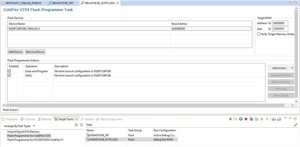

I'm using a M54451EVB dev board with a MCF54455 chip.
I'm running a baremetal application..
I'm trying to load my elf file into flash memory with ColdWarrior 11.0
I've imported both M54451EVB_SPI.xml and M54451EVB_EXTFLASH.xml flash configurations.

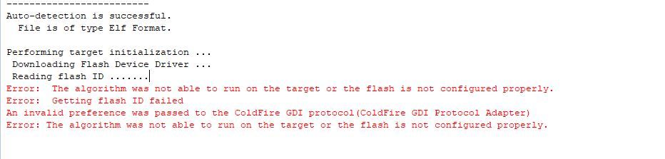

No matter which configuration I use, I get the following error:
Here's my target Task setup:

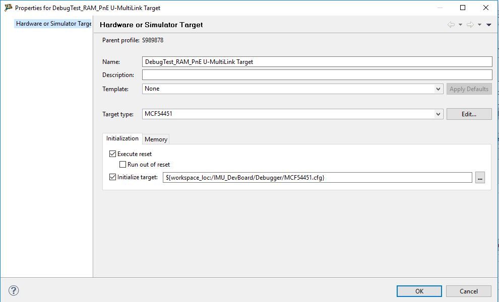

My Hardware Connection settings:
My linker script is attached below.
Thank you.

You mentioned "I'm using a M54451 board with a MCF54455 chip." This let me think that you do not use the M54451EVB.  If yes, so you can not use the Flash algorithmic of M54451EVB directly.
3,852 Views
zwilcox
Sorry.  Let me clarify.  I am using the M54451EVB.

So when was the last time your setup worked, and what have you changed since then? Pod? Computer? CodeWarrior Version? PCB Design or layout? Flash chip brand or model?
I would suggest using the lowest-level tools you can get to see if the pod is working and how much it can do. With all the drivers and layers needed to get these things working under an IDE, it is rare to get useful error messages (as you've shown).
The setup THINKS it has downloaded a "Flash Device Driver", presumably into static RAM. I don't believe that worked unless the code reads the driver back. We don't know that. As far as I know it sent it down, tried to run it and asked it for the "Flash ID" and that's the first point where it can detect a failure.
Can you load code into RAM and single step that?
Or have you already done all that and narrowed the problem down to a specific area and I'm wasting time here?
I can load binaries it into the SRAM.  My problem, as I stated, I cannot program/load them into the flash.
>So when was the last time your setup worked, and what have you changed since then? Pod? Computer? CodeWarrior >Version? PCB Design or layout? Flash chip brand or model?
This dev board (M54451EVB) is new.  We have not be able to program the flash with CW since purchase.
CW 11
The datasheet state the flash is 28F128P33
