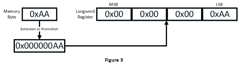

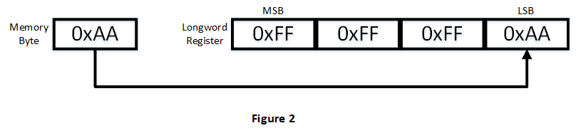

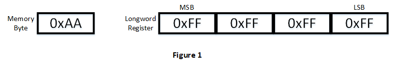

My question is: How do the MOVE.B or MOVE.W instructions behave when the source is a byte or word, but the destination is a long register (e.g. D0)?
For example, Figure 1 describes memory contents before a MOVE.B:
Assuming the instruction is something like: MOVE.B (A0), D0  ; Move indirect byte at A0 into D0
Does the execution of the instruction perform the behavior described in Figure 2 or Figure 3:

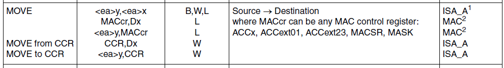

For either answer, where does a datasheet describe the behavior? The descriptions of MOVEQ, MOV3Q, and MOVEA in the CFPRM (https://www.nxp.com/docs/en/reference-manual/CFPRM.pdf) match Figure 3, but the description for MOVE (PDF pg. 123 or printed pg. 4-47) is not clear on its behavior.
Edit: Followup question if Figure 3 is correct: Would the 0xAA value be sign-extended to 0xFFFFFFAA?

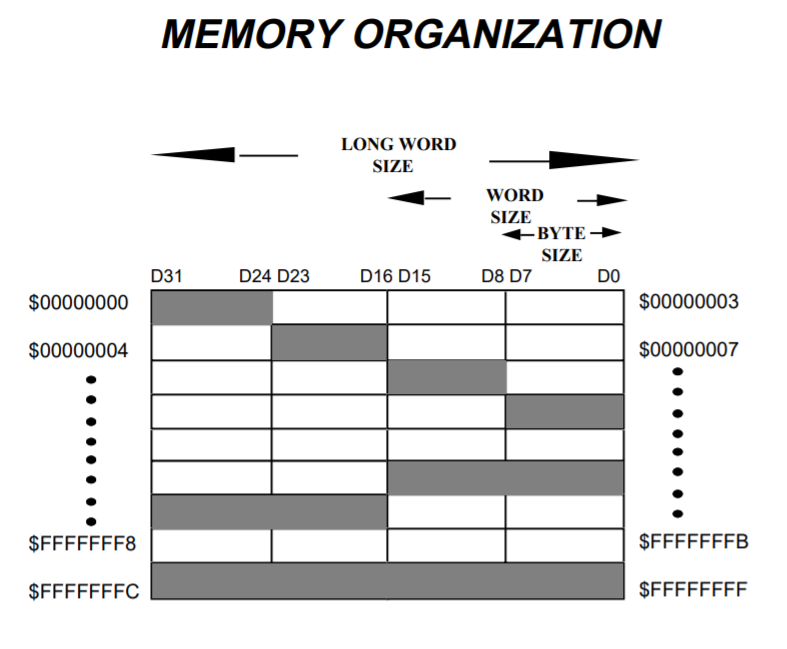

There is a training material about ColdFire core, which provide some info for your reference.
The memory organization with below types: byte, word and long word.
From the ColdFire programmer reference maual, MOVE intruction support opreation size: B, W, L,
Then I think MOVE intruction use Figure 2 to transfer byte data to register.

Each integer data register is 32 bits wide. Byte and word operands occupy the lower 8- and 16-bit portions
of integer data registers, respectively. Longword operands occupy entire data registers. A data register that
is either a source or destination operand only uses or changes the appropriate lower 8 or 16 bits (in byte or
word operations, respectively). The remaining high-order portion does not change and is unused and unchanged.
The standard approach is to load the byte or word to a register, and then use EXT.W, EXT.L or EXTB.L as appropriate for signed data. Otherwise you can have to CLR.L the destination register first if you want unsigned.
Also remember a byte load or store on a register operates on the least-significant byte like you'd expect. Doing the same to a 32-bit value in memory and storing a byte to that stores in the UPPER byte. You have to use "address+3" to write to the lower one.
