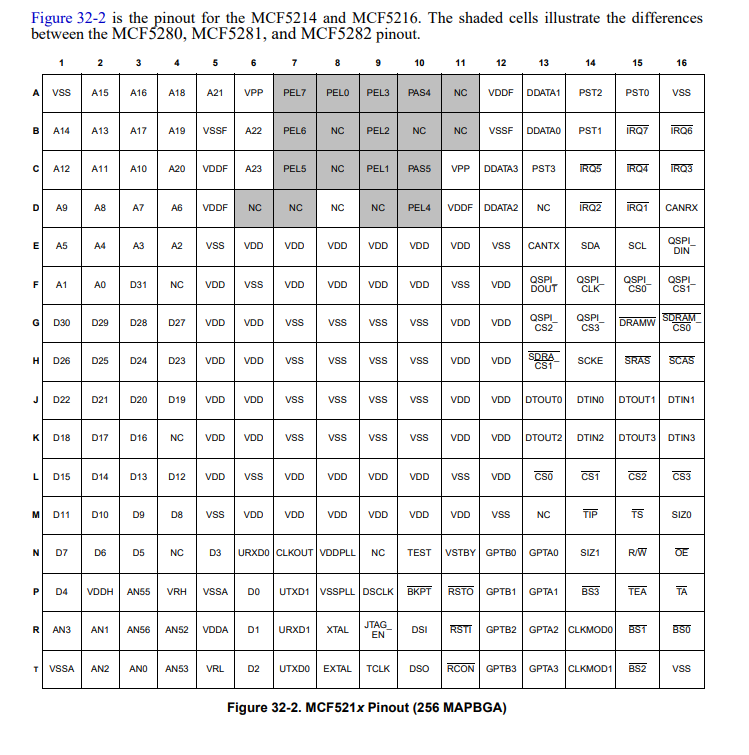

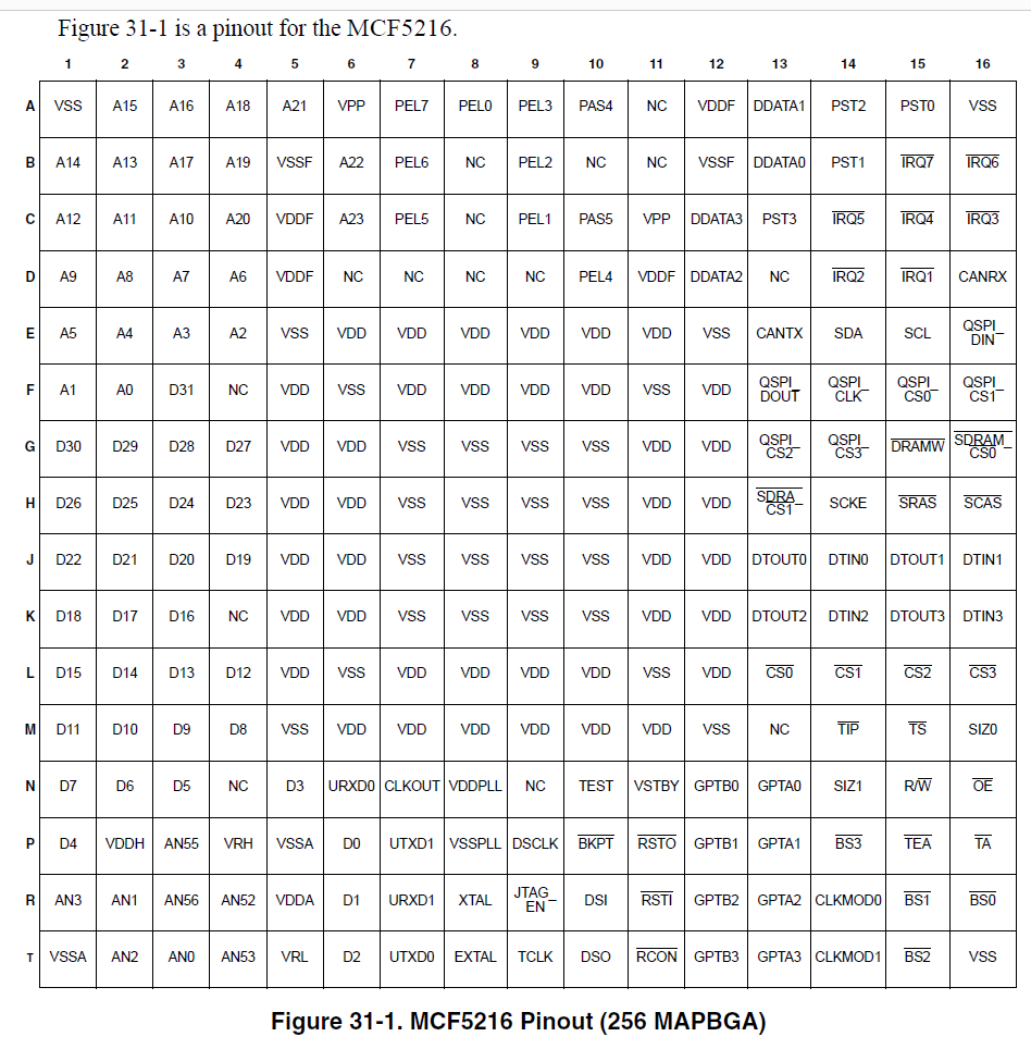

I am looking for datasheet MCF5216 with pinouts, but I have found user manual https://www.nxp.com/docs/en/data-sheet/MCF5282UM.pdf
Could you share pinouts for MCF5216?
Thank you.

Please refer attached MCF5216UM about MCF5216 pinout info:
Wish it helps.
