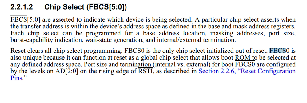

I think there's a small error in the MCF548x Reference Manual.
On page 2-2, Figure 2-1. MCF548x Signals, it lists  FBCS[5:1] / PFBCS[5:1]  (I've underlined instead of overlined)
Beneath it, it has  FBCS0 with no overline/active low signal.
It also show's it again on page 2-3
However, on page 2-11 it has the over line for FBCS0
Also again in Section 2.2.1.2 on page 2-16.

I double checked what you had mentioned, yes, you are correct. The FBCS0 really an active low signal, so the manual is not consistent. I will let the document team aware this and thanks for your kindly remind.
