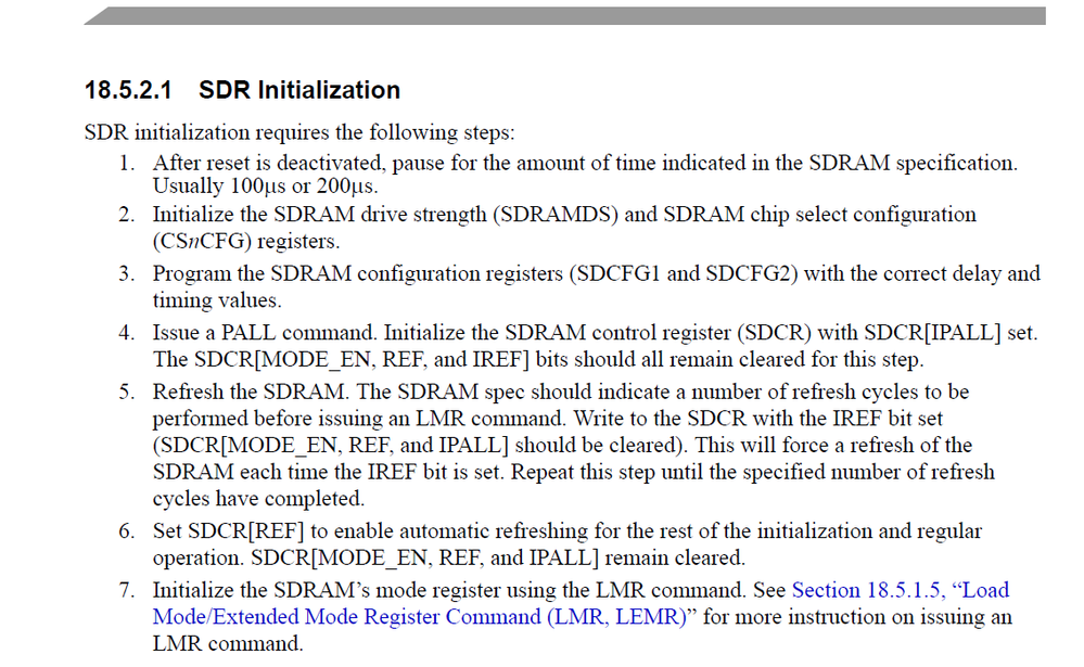

I've got an existing design using a MCF5484 that has been working fine for many years. Unfortunately, the Micron SDR SDRAM that we were using is now obsolete. We switched to an ISSI part and now have intermittent problems.
We are using two 256Mb, 4Mx16x4 parts with control and address wired in parallel to provide a 32 bit bus. My colleague has taken scope measurements of the SDRAM signals at power-up which show an attempt to program the MODE register in the SDRAM as the first activity on the bus. The data sheets for both SDRAM parts show that we should NOT be programming this register that early.
One thing that is puzzling to us is that we don't write to the ColdFire register that should program the MODE register until later in the startup sequence. What could cause this? Could it be happening when we program the chip select?
Since this design works with the Micron part and occasionally fails with ISSI, I suspect that the parts are reacting differently to something in the start-up sequence.
What is the best order to program the SDRAM registers?
Don't assume that that difference that you're seeing is the cause of the problems you're having.
If you think there's a problem with the initialisation, you should be able to repeat it. Make the initialisation sequence run twice (or more) and see if the system works after the later sequences.
Concerning the "writing to the mode register" that you're seeing. Does it do this from cold power-up and/or soft reset? We had a problem (detailed as the second one below) where the SDRAM controller generated illegal cycles on cold power-up, but was OK on normal resets.

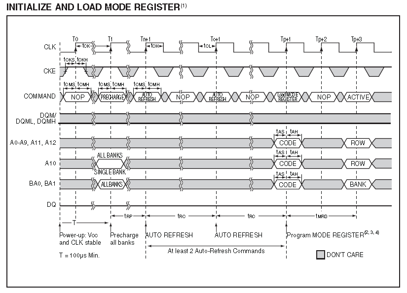

The data sheet for my SDRAM includes the following timing diagram for startup.
According to this, the clock (CLK) needs to be stable prior to starting the 100 us delay. The text description also implies that CLKE needs to be high during this period.
What starts the SDRAM CLK running? And what causes CLKE to go high?
Our initialization sequence is similar to that recommended in the MCF548x RM except that we done enable auto refresh until after we initialize the MODE register. We are also seeing an unexplained attempt to load MODE on our oscilloscope that occurs before the first precharge. What could be causing this?

miduo
If you look at the reference manual for MCF548x, there list the SDR initialization procedure. From that, it seems that the MODE register really not accessed that early. I do not see your code on system initialization. Anyway, I attached the code we used with MCF548x for you reference.
