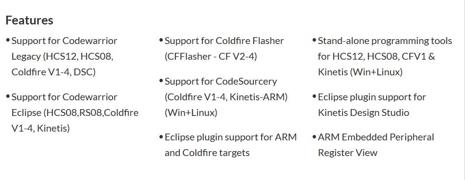

I am still battling to get my USBDM device to program the MCF5213 MCU's.
In the USBDM CFVx programmer software there seems to be no definition of the MCF5213 device despite the fact that USBDM is supposed to be able to program CFV2,3&4 devices.
How can I get the MCF5213 supported to be able to program them?

Debug support requires there to be a description of the chip so the debugger can set up initial clocks, I/O and memory. Then you usually load your program into RAM and test it from there.
Programming support requires all of that plus a description of, and code for programming the Flash memory. There is usually a small program that is loaded into the SRAM on the CPU to communicate with the debugger and to do the programming. The MCF5213 has internal Flash, so that's only one "target". If you were using external Flash (like on an MCF5235) then there has to be a downloadable programmer for every different Flash type and every bus width - or the downloaded code has to be very flexible to handle all combinations. Then you might be using multiple chip selects that makes it more complicated.
What we do (for the MCF5235 we use) is to have a RAM-loaded Bootstrap that knows how to program the Flash. We use the debugger to set up the clocks and external Flash and RAM and then load the debugger and run it with a flag setting that tells it to "burn itself to Flash". Then we talk to it over Ethernet to burn the main firmware.
You could always write your own Flash-burner program and load that into SRAM. You could then burn from communicating with the Debugger, over a serial port, CAN or SPI. Or you could use EzPort.

Well, you may see below:
This is the feature for USBDM software you mentioned, it does not support stand-along programming for CF V2.
It mentioned "support for ColdFire Flaser CFFlaser - CFV2-4" However, the CFflasher had EOL for server years and we do not support it any more.
