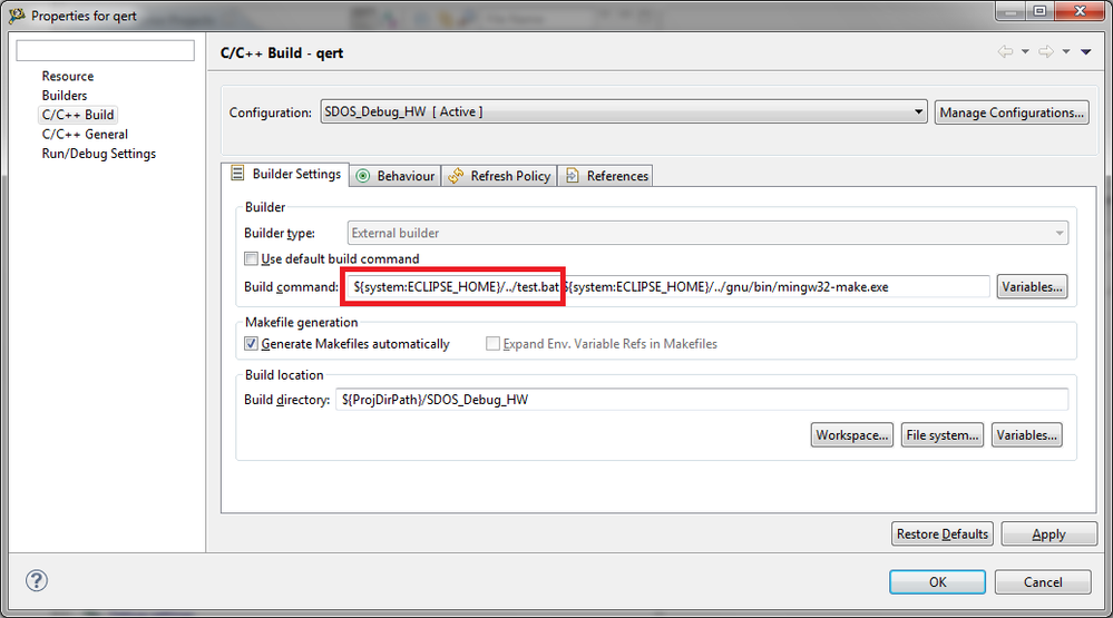

Please try this way:
#1: remove any references from the pre-build commands;
#2: go to project properties at Builder settings and change the build command like below. Please note that the bat file must be the fist argument.
#3: Edit the test.bat file to contain make file like commands. E.g.:
@echo This is a test
@dir
@cmd /c "%*"
@exit
This way the CW should not recompile each file within the project each time you execute a build command.
In this particular case the second time you click on build the console should display something like this:
D:\CW\CW_SC_v10.5.0\test.bat D:\CW\CW_SC_v10.5.0\eclipse/../gnu/bin/mingw32-make.exe -j8 all

mingw32-make.exe: Nothing to be done for `all'.
As can be seen in this case the maker return: mingw32-make.exe: Nothing to be done for `all'. If a file is touched only that one will be compiled.
For your reference i used the CW10.5.0
Hope it helps!
