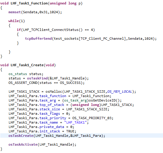

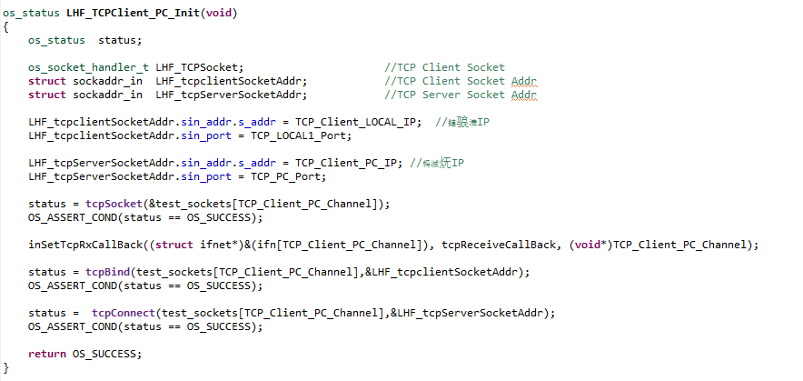

// This is my App(I omitted a part of the TCPIP initialization screenshot)

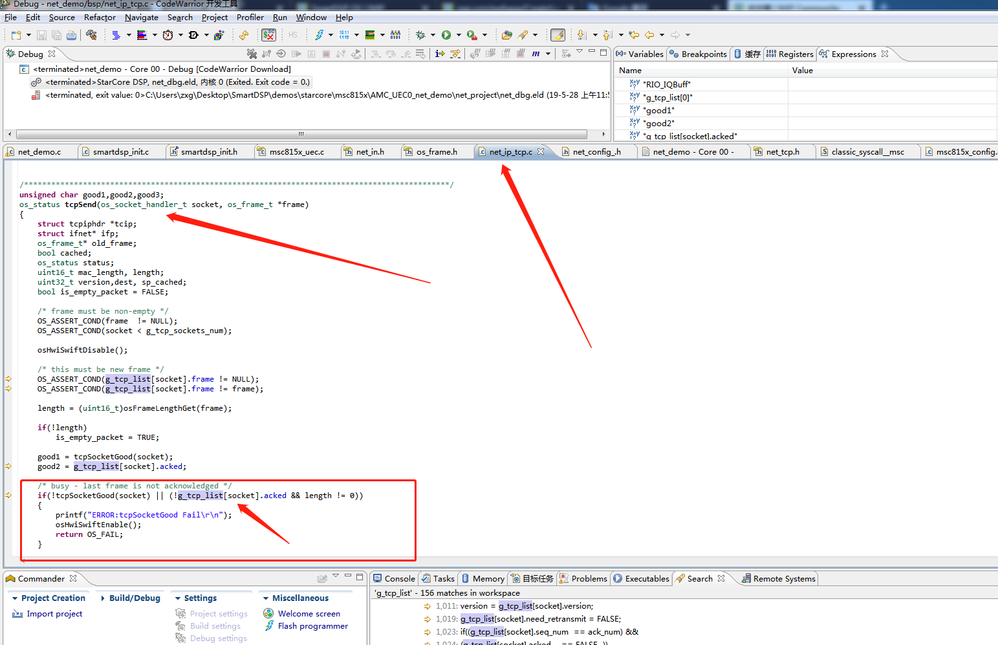

Hi:
I continue to find the problem today. During the simulation, I found that the reason why TcpSendBuff is slow to send is because TcpSendBuff returned an error when calling TcpSend. The place where the error occurred is as follows:
The return value of g_tcp_list[socket].acked is 0.So it will cause me to send out data and sometimes publish data.How can I solve this problem?

Sorry, it should be tcpBufferSend, not TcpSenBuff

This is AE reply:
customer needs to debug how the g_tcp_list[socket].acked  is used and allocated value to trace the root cause.
