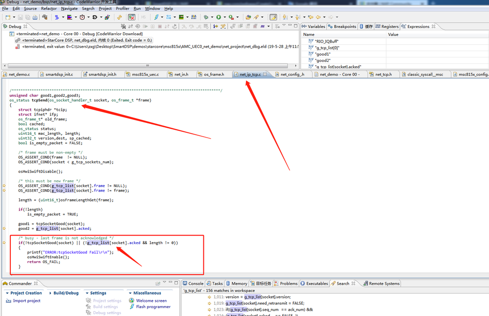

I continue to find the problem today. During the simulation, I found that the reason why TcpSendBuff is slow to send is because TcpSendBuff returned an error when calling TcpSend. The place where the error occurred is as follows:
The return value of g_tcp_list[socket].acked is 0.So it will cause me to send out data and sometimes publish data.How can I solve this problem?
17,260 Views
819277784
Hi:

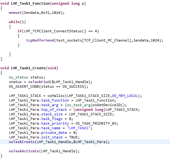

Hi xiangjun:
I am already in the testing phase. When I tested the SGMII of MSC8157, my MSC8157 was doing a TCP client. The PC was a TCP server. The client could connect to the server and communicate easily. I encountered a very strange problem during the test. My specific operation is as follows:
After the client connects to the successful server, it will continue to send 1024 bytes of data to the server, but from the speed of receiving data from the server, there is only about 5-9KBytes per second (5 to 9K bytes/second). ), this feeling is very abnormal, the speed of the Gigabit network port should be at least a few megabytes, why is my only a few K bytes? Here is my configuration:

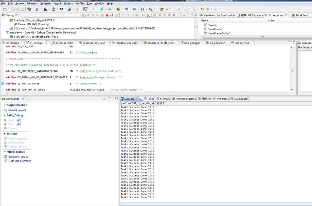

819277784

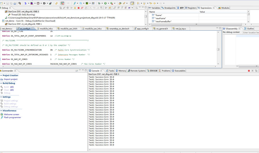

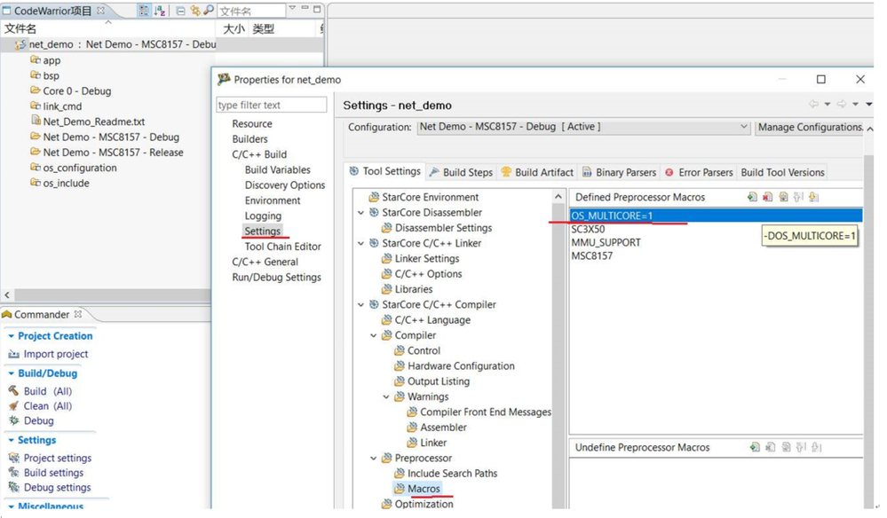

My configuration on Core in os_config.h is as follows:
Then I performed multi-core simulation and run, observing the information printed by the serial port. From the point of view of the printed information, now 6 Cores are running. Can I understand this?
17,260 Views

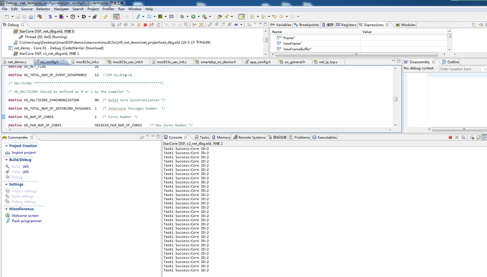

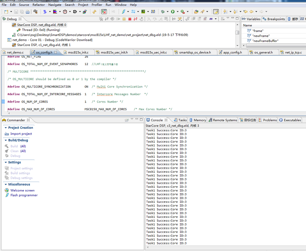

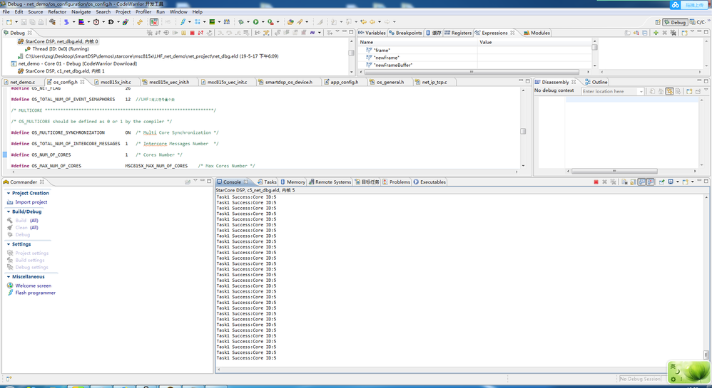

819277784
Multi-core simulation and synchronization I found a manual, according to the manual, it seems to be ok, but when the multi-core is running, it will enter the osHwiDMMUError error.
What is going on with this?
This is my new multi-core configuration.
17,260 Views

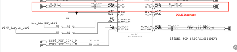

Hi,xiangjun
Previous about osWaitForAllCores() The problem of not running has been solved.Thank you very much!
My SGMII has not been running normally. Can you tell me how to use SGMII correctly? Codewarrior's own demo will not work, I don't know why, I don't want to entangle those demos now, I don't need to prompt anything, I hope you can tell me what to do to use SGMII correctly, it is best to explain once, otherwise one day A message, the progress is too slow,
thank you very much for your help.

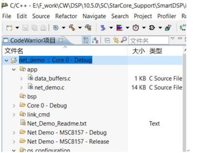

xiangjun_rong
Hi,HaiFeng
please refer to those demos prefixed with 'net_', like net_demo, net_ip4_ip6_demo ... in folder \SmartDSP\demos\starcore\msc815x
Xiangjun rong

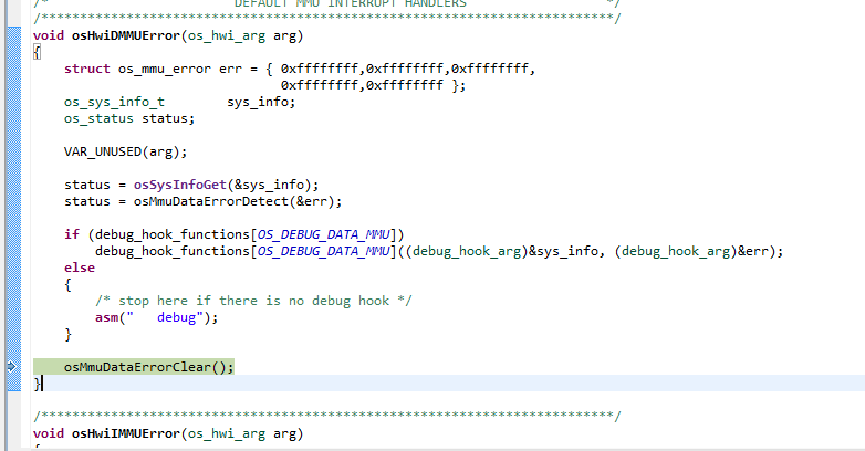

819277784
hi,xiangjun:
I tested the demo at the beginning of net_, but it will die in the void osHwiDMMUError(os_hwi_arg arg) function, always waiting for osWaitForAllCores(); this function does not pass. My interface is SGMII.
17,258 Views

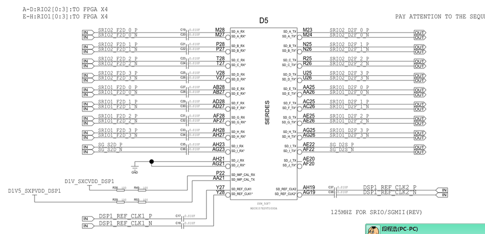

819277784
This is my own MSC8157 project, using SGMII, I don't know if it is right. I hope that if you have time, can you help me to look at it? I blocked all osWaitForAllCores() in it, because this function will cause my program card to die inside, so I disabled this function.
