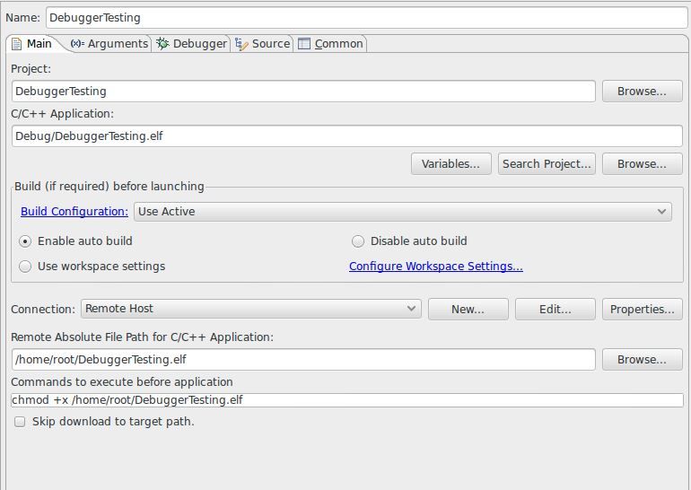

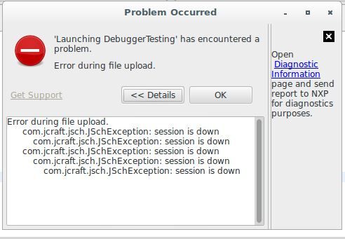

While trying to debug Linux application on the Codewarrior ARMv8, i see the below error:

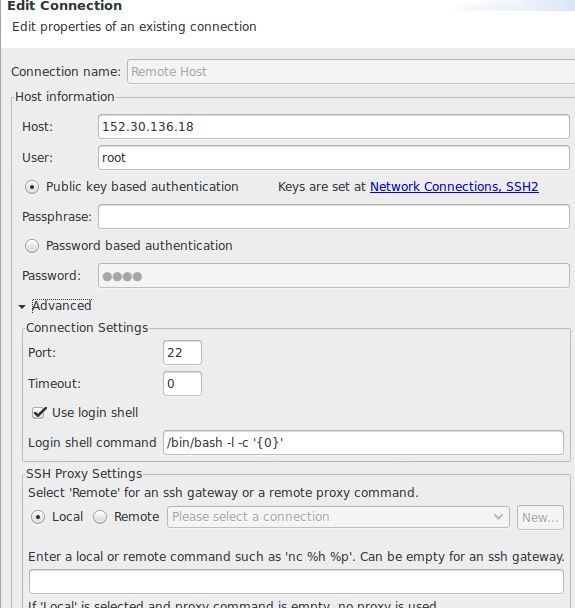

I have followed the steps listed in the ARMv8 targeting manual "Section 8.2.2.2 Updating remote connection".
Below is the snapshot of my "Debug Configurations" and "Remote Host connection settings"
I am able to connect to the target from my terminal over ssh. But I am not sure why I am running into this error.
Could you please provide some insight into this.

I know this is an old thread, but I am also having the same difficulty. I believe it is some sort of ssh authentication issue, but I can't trace it down. jc_lanka, did you solve the issue? What did you discover about it? Is the JTAG connection required for the Linux Application debug? Any insight that anyone can provide would be a big help.

I am actually trying to debug a Linux application using Gdbserver and GDB on CodeWarrior.
There isn't any JTAG connected to the device. I am starting a gdbserver on the target device, and I am trying to debug using the code warrior remote application debug configuration (Sec. 8.2.2.2 - ARMv8 Targeting Manual). This is when I see the error.
Attaching to a running Linux application (sec. 8.2.4) on target has no issues, but starting debugging from the CW, I am running into the above mentioned error.
Please let me know if I am not clear or missing something.
