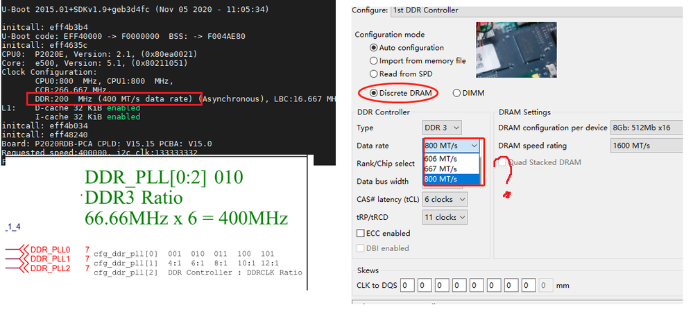

1. my board SMT Memory Cell  directly, and  no spd eeprom , so i should select the discrete dram?

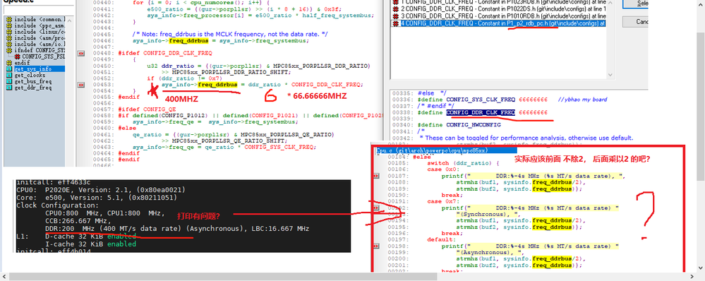

2. what's the difference between “DDR :200MHZ "  and " DDR date rate 400MT/s ",  the DDRCLK is set to  400MHZ by starpping pin, the uboot message is right?
 i think it should be print “DDR : 400MHZ” and " DDR date rate 800MT/s ",so this is uboot bug?
3. i don't see the " DDR date rate 400MT/s " in QCVS ddr configuration tabs, why?

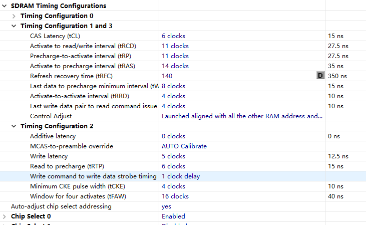

1. does i can use the timing of above as default init value  before learning ?  if not ,  which critical param should i set , have some document?
2. which script sould i run?

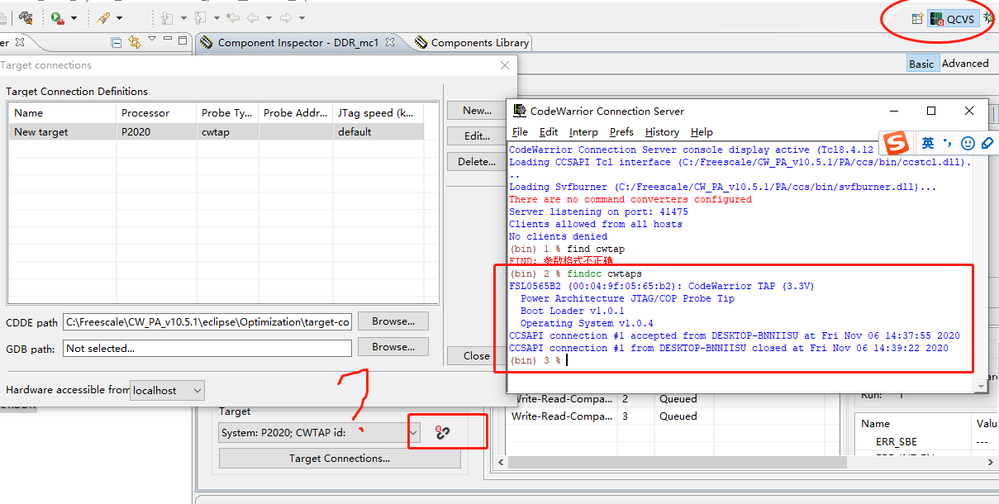

now i can find cwtaps at ccs, and can connect chip at debug mode.  but  at QCVS mode ,i can't connect , thank you

1. You could select discrete dram.
2. u-boot is correct, DDR clock frequency is 66.66/2*6=200MHz, data rate is 400MT/s.
3. Please create a QCVS DDR project, then double click "DDR_mc1:DDR" component to show Properties panel, you could configure "DDR Bus Clock" as 200MHz in the Properties panel.

why uboot print ddr clk  should div 2?
2,809 Views
ybhao
can you tell me ,  66.66/2*6=200MHz,    div 2 , where i can see the div 2 ?  thank you very much
2,799 Views
yipingwang
Please refer to the section "System clock and DDR controller clock" in P2020 Reference Manual.
