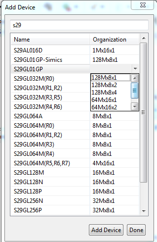

Hi All,
I am using T4240RDB-64B machine with codeWarrior Flashprogrammer V10.7.   And I got the following log when flash the u-boot. I want to give restricted address range for program.
How to find the flash start address and end address for u-boot to t4240rdb-64b machine.
Inline image
Flash Log:
l::target -lc "Peacock_10thDec-core00_RAM_T4160_Connect"
fl::target -b 0x0 0x100000
fl::target -v off -l off
cmdwin::fl::device -d "S29GL01GP" -o "128Mx8x1" -a 0xe8000000 0xefffffff
cmdwin::fl::erase all

Hi Pavel,
Thank you for your response.
I followed table 110 for memory map and I used the "0xEFF40000 to 0xEFFFFFFF" for uboot erase and program action.
But, still I got Sector Protection Error.
Please give some more details to fix the following errors,
Error: Erase failed. Flash driver reports the following error(s): Sector Protection Error

monalihaware
Hi Vinothkumar,
I am using p2020 RDB and i got various errors while programming BIN file onto it. Additionally, it would say "program successful" in flash programmer but "0 bytes written".
Finally, what worked for me is following-
1. As it is RDB, i imported the xml file (in flash programmer-> task) for RDB from the installation path. As urs is T4240, import in 'task' the xml file from PA/bin/plugin/support/targettask/flashprogrammer/QorIQ_T4240/T2040RDB_NOR_Flash.xml. This wil automatically select the various options needed for the NOR on your RDB
2.In 'add  program/verifyaction' tab,give the path of the bin file
check 'erase sector before program'
check 'restrict to address in this range'  and give start and end address as start & end address of your NOR flash
check 'apply address offset' and give address as onto which location you want to burn the bin file. For Ex- my flash addr range is 0xff00_0000 - 0xffff_ffff.  so i gave this start( 0xff00_0000) and end(0xffff_ffff) address in 'restrict to address in this range' .  And i wanted to burn bin at "0xff04_0000' .
So i gave the ''apply address offset'  as  "0xff04_0000 "
3.Run the task
Actually, The following thread helped me and worked
https://community.nxp.com/thread/391994
Even i observed that if any slight mistake/mismatch in xml for the flash, the flash programmer wont be able to write/erase etc as per user's desire.
I hope this helps. But if it is your custom board then u need to work out on xml. I have not done it yet for custom board. i need to do that next.

vinothkumars
Senior Contributor IV
Hi All,
From s29GL01GS datasheet, Flash Chip: S29GL01GS  and Device ID: 227E
From CodeWarrior IDE, Flash Chip Driver: S29GL01GP and Organization : 64MX16X1
From S29GL01GP.XML,
    Sector Protection Error will appear using this 64MX16X1 Organization.
    But, When use the 128MX8X1 Organization, There is no error but, program execute continuously.
    Difference between these two Orgainzation is flash algorithm.
Inline image
Inline image

vinothkumars
Hi All,
What is the difference between S29GL01GS and S29GL512S Flash Device ?
I am using S29GL01GS and I select Organization as 64MX16X1.
or
I Want to Select  Organization as 128MX8X1.
Which one I want to select to program using CodeWarrior Flashprogrammer?
Thank you for all your support........!
Regards, VinothS
Vinothkumar Sekar

vinothkumars
Hi All,
Still I am struggled with the organization selection for S29GL01GS
And I followed this datasheet,
http://www.cypress.com/file/177976/download
From that which Organization want to select for CodeWarrior Flashprogrammer.
Thank for all your support.......!
Regards, VinothS
