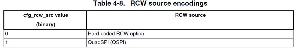

First please check whether there is valid RCW on the target board.
Please configure your target board as hard-coded RCW through cfg_rcw_src. The reset configuration word (RCW) source input, cfg_rcw_src, is multiplexed on CLK_OUT. This configuration input selects the source for the RCW data as shown in the following table.
Then check whether there is problem to reset the custom board when run QCVS DDRv validation.
In addition would you please capture the low level CCS console log to me to do more investigation?
When you connecting to the target board, the CCS console will be invoked automatically at the right bottom of the Windows task bar, please type "log v", then connect to the target board to do DDR validation again, the low level CCS log will be captured in the CCS console.

I have tried as you have asked and I have made the input to cfg_rcw_src 0.
I have run the tool again and I have the output from the ccs console here:

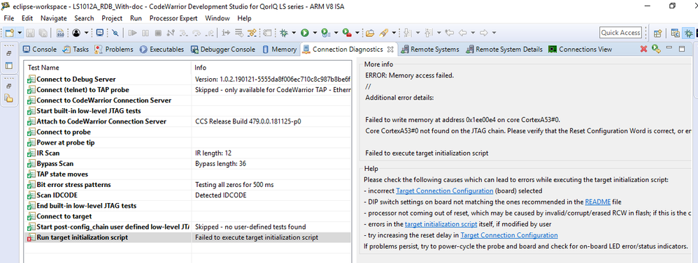

I have tried to look at debugging a project on the board and I am met with this error
Can you advise on what to do next?
Many thanks,
Nic
