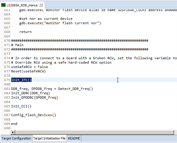

Could you please elaborate on the second point?  I am unable to find IFC settings in gdb python initialization.
2. NOR flash initialization is not correct in the gdb python initialization (check the IFC settings)
Rams
3,869 Views
marius_grigoras
Hi Rams,
Basically I need the content of Init_IFC() function from the gdb python script (double click on the TCC and this file will be opened).
Thank you,
Marius

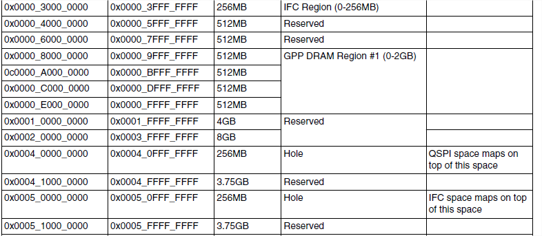

We could not find any reset sequence and flow diagram in the documentation.  Do you have any internal documentation explaining the reset flow diagram for LS2085A?
Like after POR, start -> SP loading RCW -> DDR init.. PLL init ->Pre Boot initialization - Jump to Flash @Addr -> Starting U-boot  ...etc.  If something fails in between, can we look at other registers to know the status of the CPU.  Without these, it is very hard to debug bareboard.
When RCW is configured to boot from flash, how does it jump to vbank0 @0x58000_0000?
We just have codewarrior documentation and high level u-boot debugging in ARM targeting manual.  That does not seem to help us during this stage.
Rams
3,868 Views
marius_grigoras
Hi Rams,
I don't have any public doc explaining the reset flow, but please submit a new case to nxp.com (will be contacted to sign a NDA and mostly will get that doc to see more details) or contact your local FAE.
But long story short, the booting process is:
1. SP boot
- comes out of reset in secure-privileged state
- fetches instruction at 0x0 (reset vector)
- writes BLP register (very useful for GPP)
- releases GPP boot core via BRR register
- executes wfi (wait for interrupt)
2. GPP boot
- comes out of reset in secure (EL3) state
- brancy to secondary boot loader address found in BLP
- and now the u-boot code will make the IFC and DDR initialization (and of course other peripherals) and will relocate itself to DDR (main memory).
Regarding your question about how the u-boot will know to jump just after reset to 0x58000_0000 - this is a good question and the answer is simple: the memory-map for this SoC is hardcoded. Take a look at the chapter 2.2 from RM (System Memory Map) - you can see the IFC Region can be accessed from 0x3000_0000 and also from 0x5_8000_0000.
At boot time, based on the default CPSR (0x101) and AMASK (0x0) values you can access the NOR windows from multiple ranges.
x 0x30000000
0x30000000: 0xaa55aa55
x 0x38000000
0x38000000: 0xaa55aa55
x 0x588000000
0x588000000: 0xaa55aa55
x 0x580000000
0x580000000: 0xaa55aa55
x 0x500000000
0x500000000: 0x00000000
x 0x598000000
0x598000000: 0xaa55aa55
x 0x5A8000000
0x5a8000000: 0xaa55aa55
Also, quoting from LS2085A RM:
"For NOR boot, CS0 works as the boot chip-select. Therefore, during NOR boot, the external device should be connected on CS0. Before fetching the first instruction from an external device (NOR flash), the IFC flash timing registers are loaded with default timing parameters."
"CSPR0: Only chip-select 0 is used for booting. PS, MSEL[1], and TE is obtained from the configuration word when boot_load/rcw_load occurs. V will be set for CSPR0 when boot_load/rcw_load occurs with valid port size."
Marius
