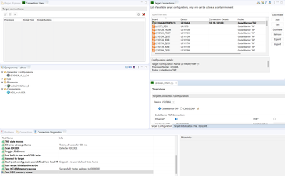

Hello everyone,
I’m reaching out after spending several days attempting to bring up the CodeWarrior TAP with the FRWY-LS1046AGSG board for initial debug and SerDes configuration using QCVS. I have a strong embedded background and carefully verified all configuration steps, but my PCs failed to connect to CWTAP and fails to detect the target SoC.
Setup:
  • Board: FRWY-LS1046AGSG
  • CW TAP Kit:
    • CWH-CTP-BASE-HE
    • CWH-CTP-CTX10-YE
  • Connections -different PC/OS-:
    • PC (Windows 10 / Windows 11 / Linux) ↔ Ethernet/USB ↔ CWTAP ↔ JTAG ↔ LS1046
  • Software: CW4NET v2020.06, QCVS, CCS

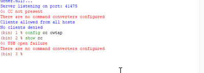

What works:
  • CW TAP was configured via serial console (see screenshot below).
  • CWTAP and PC can ping each other.
  • I can run the following and get version response from CW TAP:
  • findcc discovers the TAP ( I've connected the USB and the Eth).
What fails:

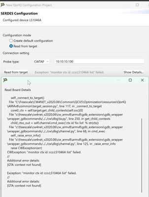

cannot find the CWTAP USB
QCVS SerDes Configuration Tool Failed:
  • Target is powered, not held in reset, and run the default QSPI and tried to run the SD Card that comes with FREEWAY board which contains ubuntu 18. ( I interrupt u-boot)

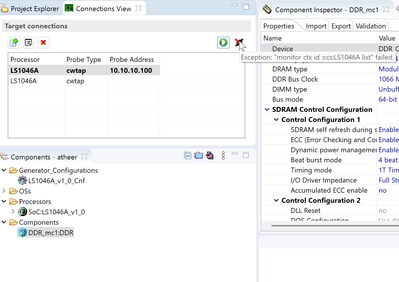

Bandar
Dear June thanks for your support I identified the main issue is the update, once I try to apply update as you mentioned or from online
I got this error
and if this error for some reasons the Target connections is dispersed and show an error once it been loaded
so the area in red is showing no devices
so I decide to skip the update and just install it the executable file and everything works fine
Thanks again!

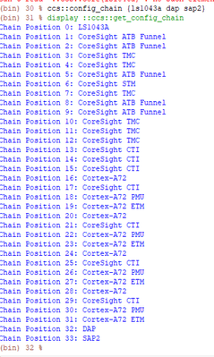

It seems idcode.tcl works well.
Try the command below:
ccs::config_chain{ ls1043a dap sap2}
display ::ccs::get_config_chain

Bandar

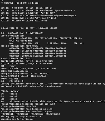

Please find the results here
this is the output of u-boot from freeway dev board
but still I cannot connect from cw !
4,971件の閲覧回数
June_Lu
Is the FRWY-LS1046A could bring up with logs output?
Have you every linked the CWTAP with the ethernet?
4,950件の閲覧回数
Bandar
FRWY-LS1046A shows the output logs and shared in screenshot above.

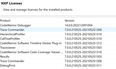

"duplicate" FRWY-LS1046A in the CodeWarrior(CW) IDE, set the "Target Configuration" with your Ethernet IP, run "Diagnose", if it passed, CW IDE works well.
How about your CodeWarrior(CW) IDE license?
https://www.nxp.com/design/design-center/software/development-software/codewarrior-development-tools...
Developer Suite Level
Specialist Suite Level
Only "Specialist Suite Level" could support DDR QCVS.
4,916件の閲覧回数
Bandar

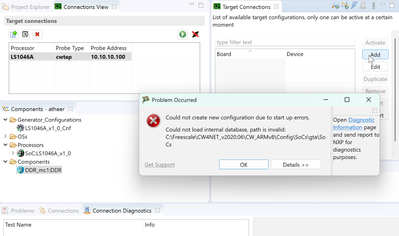

This is my CW version, and for now I'm using the evaluation license

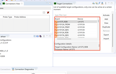

Regarding the Diagnostic, I opened the Target Connections Windows and try to add Board but it give me error
"Could not create new configuration due to start up errors.
Could not load internal database, path is invalid: C:\Freescale\CW4NET_v2020.06\CW_ARMv8\Config\SoCs\gta\SoCs"
while I can see the Connection View Windows I can add my target but the connection failed
Lastly, why we chose LS1043A and LS1046A not exist in CCS?

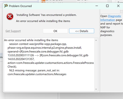

Could you confirm if the evaluation version is not expired? When do you download the CodeWarrior?
Please install CodeWarrior® Development Suites for Networked Applications 11.5.12 to run the QCVS DDR.
Please find link below:
Select DOWNLOAD EVAL
 Download update package
com.freescale.armv8.11.5.12.GA.Win.updatesite.221209.zip
Please open CodeWarrior from C:\Freescale\CW4NET_v2020.06\CW_ARMv8\fsl_eclipse.bat, and install the update package from Help->Install New Software->Add->Archive.
Please reopen CodeWarrior in a new workspace.
Please confirm the "Diagnose" works well, please follow C:\Freescale\CW4NET_v2020.06\CW_ARMv8\ARMv8\Help\PDF\ARMv8_Targeting_Manual, 5.1 Target Connection configurator overview
If it could not work correctly please reinstall the CodeWarrior again.
After confirm above, try the QCVS again.
Please use "ccs::config_chain{ ls1043a dap sap2}" to connect LS1046A, any other command is not available.
4,862件の閲覧回数
Bandar
I got this error
Thanks again!

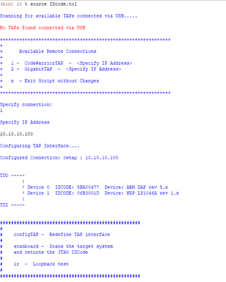

Bandar
if I source IDcode.tcl It confirms the setup is properly set
