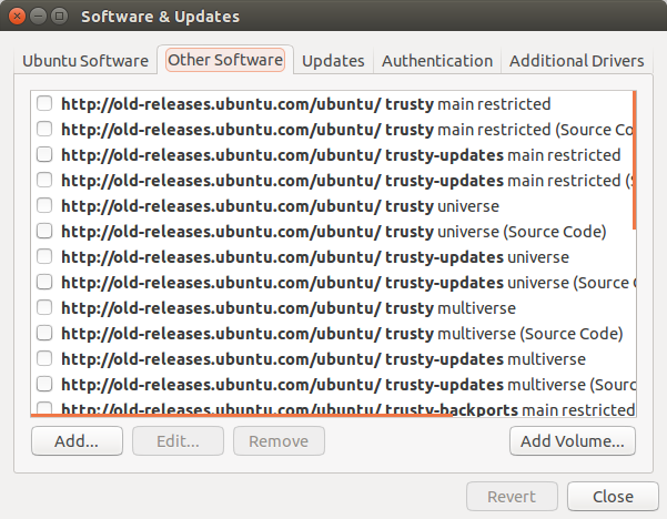

I attempted to install the dependencies manually as it mentioned in the README file (paragraph 2.13 Ubuntu 13.10 /14.04):
# sudo sed -i -re 's/([a-z]{2}\.)?archive.ubuntu.com|security.ubuntu.com/old-releases.ubuntu.com/g' /etc/apt/sources.list
# sudo apt-get update
# sudo apt-get install libc6:i386 libgcc1:i386 gcc-4.6-base:i386 libstdc++5:i386 libstdc++6:i386 libgtk2.0-0:i386 libxpm4:i386 libusb-0.1-4:i386 libusb-1.0-0:i386 libuuid1:i386 libxcb1:i386 libnspr4:i386 libglib2.0-0:i386 libxdamage1:i386 libxtst6:i386 libssl0.9.8:i386
However I received the list of errors:
E: Package 'libc6:i386' has no installation candidate
E: Package 'libgcc1:i386' has no installation candidate
E: Unable to locate package gcc-4.6-base
E: Couldn't find any package by regex 'gcc-4.6-base'
E: Unable to locate package libstdc++5
E: Couldn't find any package by regex 'libstdc++5'
E: Package 'libstdc++6:i386' has no installation candidate
E: Package 'libgtk2.0-0:i386' has no installation candidate
E: Unable to locate package libxpm4
E: Unable to locate package libusb-0.1-4
E: Couldn't find any package by regex 'libusb-0.1-4'
E: Unable to locate package libusb-1.0-0
E: Couldn't find any package by regex 'libusb-1.0-0'
E: Package 'libuuid1:i386' has no installation candidate
E: Unable to locate package libxcb1
E: Package 'libnspr4:i386' has no installation candidate
E: Package 'libglib2.0-0:i386' has no installation candidate
E: Package 'libxdamage1:i386' has no installation candidate
E: Package 'libxtst6:i386' has no installation candidate
E: Unable to locate package libssl0.9.8
E: Couldn't find any package by regex 'libssl0.9.8'

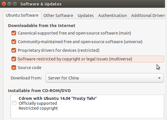

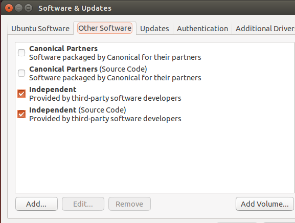

Hello Victor Mazin,
I tried on my Ubuntu 14.04 64bit, it prints message that CodeWarrior dependency will not be automatically installed, after a while when I was checking the dependency the installation go on and success.
This seems to be related with source. Attached is my sources.list.

victormazin
Hi Adrian,
Thank you for the answer.
Please see the log below.
Victor

The link which you mentioned did not help. Their recommendation "sudo rm /var/lib/apt/lists/* -vf" did not solve the problem.
I unchecked the other software in the Software Updates.Please see the picture below:
Next I tried to install CodeWarrior again. However the installation was not successful. Please the log below.
Could you give more recomendation regarding CodeWarrior installation?
Victor
