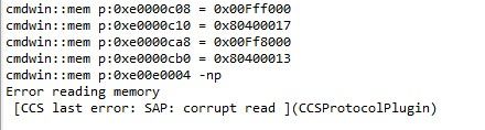

We designed a target board using p2020 CPU referring to the design of P2020RDB-PC. I must use 36-bit memory map in my target board.
Before I flash uboot to my target board, I tried to flash official 36bit-uboot to the P2020RDB-PC.
I modify relevant memory addresses in P2020RDB-PC_init_sram_flash.tcl, as following:
mem [CCSR 0xc08] = 0x00Fff000
mem [CCSR 0xca8] = 0x00Ff8000
mem [CCSR 0x0] = 0x00Fe0000
reg ${CAM_GROUP}L2MMU_CAM1  = 0x500003CAFC08000FE000000FE0000001
reg ${CAM_GROUP}L2MMU_CAM2  = 0x70000FCAFC08000FFF00000FFF000001
reg ${CAM_GROUP}L2MMU_CAM7  = 0x500003CAFC08000FF800000FF8000001
reg ${SPR_GROUP}HID0 = 0x00004080
reg ${SPR_GROUP}MAS7 = 0x0000000F
When I debug the initialization file, the console information is as followed:
What mistakes have I made in my .tcl file?

First I think you could use P2020RDB-PC_init_sram_flash.tcl to initialize your customize target board and flash u-boot.(Probably you only need to modify the address for NOR Flash)
In you want to modify the initialization file to coincide with the 36bit address space, please pay attention to the following.
1. MMU TLB configuration, please note effective addresses are 32 bit, please refer to the table "e500v2 TLB1 Registers" in CW_PA_v10.3.3\PA\Help\PDF\Targeting_PA_Processors.pdf.
    # MMU  initialization
    # define 256KB  TLB1 entry 3: 0x00000000 - 0x0003FFFF; for internal chip SRAM
    reg ${CAM_GROUP}L2MMU_CAM3  = 0x400001C0FC0800000000000000000001
    # define 1MB    TLB1 entry 1: 0xE0000000 - 0xE00FFFFF; for CCSR Space, non cacheable
    reg ${CAM_GROUP}L2MMU_CAM1  = 0x500003CAFC080000E0000000E0000001
    # define 16MB  TLB1 entry 2: 0xFFF000000 - 0xFFFFFFFF; for Local Bus, cache inhibited
    reg ${CAM_GROUP}L2MMU_CAM2  = 0x70000FCAFC08000FFF000000FF000001
    # define 1MB    TLB1 entry 7: 0xFF8000000 - 0xF80FFFFF; for NAND, cache inhibited
    reg ${CAM_GROUP}L2MMU_CAM7  = 0x500003CAFC08000FF8000000F8000001
2. For CCSRBAR, please configure as the default
mem [CCSR 0x0] = 0x000e0000
set CCSRBAR 0xe0000000
Your configuration is correct, but if specifying variable CCSRBAR as 0xfe0000000, there is some problem in the tcl script to compute the value more than 32bit.
