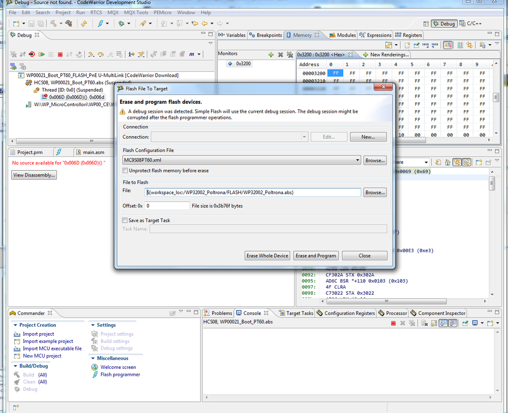

I use MC9S08PT60 and CW 10.3.
During debug mode with USM multilink, I need to program a flash sector with data value in a S19 file.
My application is at address 0x1040 and i want program the flash from 0x3200 to 0x4000 with Debug active
Using "Flash file to target" is also erased the flash, but i want to wrtite only a flash sector fron 0x3200 to 0x4000 withot delete the other sector in debug mode.
How can i do this ?

In your connection configuration you can preserve memory areas.
This article shows how to do this with P&E and CodeWarrior:
http://mcuoneclipse.com/2012/04/27/programming-part-of-flash/
