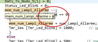

In debug mode, when work with step, when with mouse i go over a variable, i visualize his contents in ascii format.
How can i change the this format ?

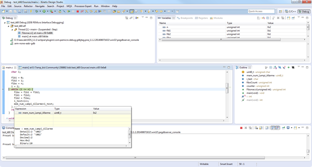

I've tried with Eclipse used on KDS development tool which is base on Kepler.
The problem is solved on this Eclipse version.
Using the same source file I see:
this is the information Erich provided before.

IlConte
This is ok, but i not understud why when with mouse go over variable in the code i look only "y" special 152 ascii character
9,838 Views
trytohelp
This depends the type of variable.
I'm pretty sure your variable is defined as "char".
By default char is using ascii format so the ascii value will be displayed.
You can change it in Variable view but not in source.
Pascal
Freescale Technical Support
9,838 Views
IlConte
The variable is defined as uint8_t consequently it is a type char
typedef unsigned char uint8_t;
uint8_t mem_num_Lampi_Allarme;
But the "y" is the 152 and don't correspond to the 02 value content
For have a uint8_t viewable how can I change the uint8_t typedef definition ?

trytohelp
Stefano,
The project I sent contains several variable types in the Fibonacci function:
    fib1, fib2, fibo are defined as unsigned int
    i is defined as char
fib1, fib2, fibo are correctly displayed in source file whereas i has same problem.
i is displayed with right value in the variables view but not under main.c

BlackNight
Hi Stefano,
you cannot influence directly the format of the hover, but you can enable the combined hovers:
http://mcuoneclipse.com/2012/10/09/hovering-and-debugging/
Otherwise: Eclipse Kepler has more capabilities: http://mcuoneclipse.com/2014/03/16/variable-debugging-with-eclipse-kepler/
