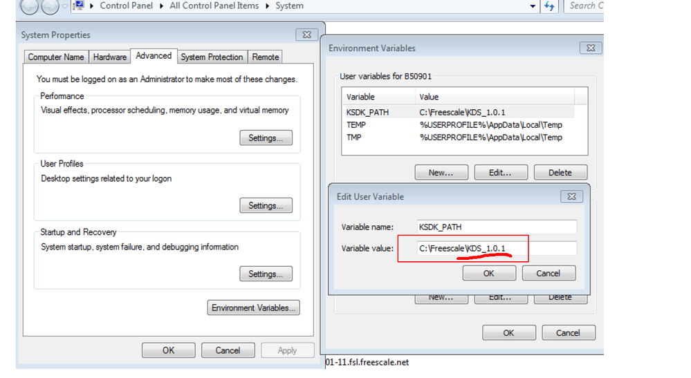

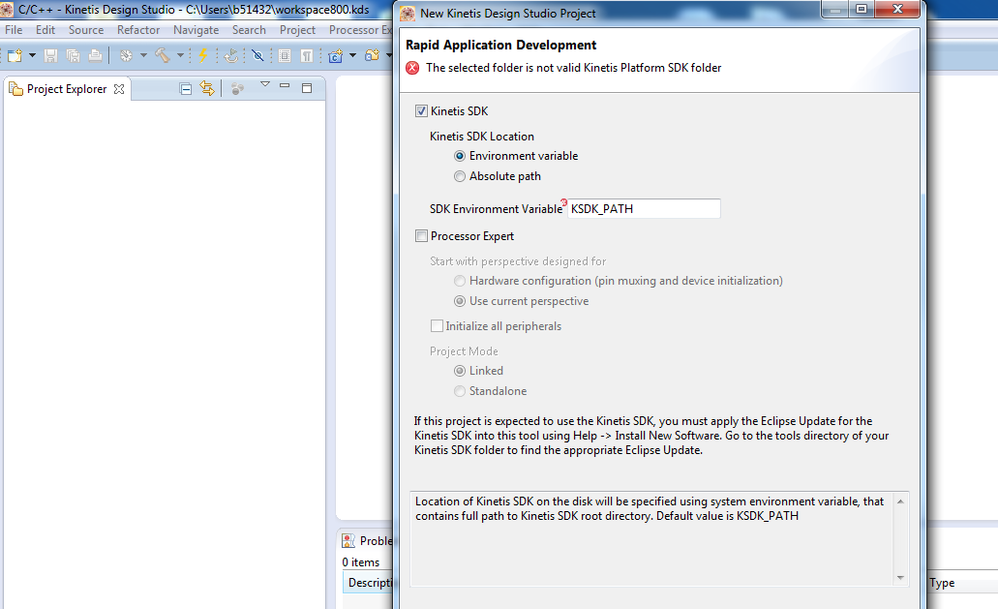

Hello
My kds 1.1.1 and KDS 2.0.0 now all error when creat KSDK project .
Before I have create KSDK project work well and run the KSDK demo code work well too, while now , it error like this
I'm sure I have config the varialbe on the computer properies refer to the user guide.
please tell me how to solve it !
Than you a lot !

Hi Linda,
what is the content of your KSDK_PATH variable?
Erich

Fan_xy
Hi Erich,
I think there is an error in the DOC "C:\Freescale\KSDK_1.0.0\doc\Kinetis SDK k64 User's Guide"

BlackNight
Hi Linda,
yes, this is obviously an error :-( I have passed this to the engineering team so they can review/fix it.
The variable needs to point to your Kinetis SDK folder, e.g.
