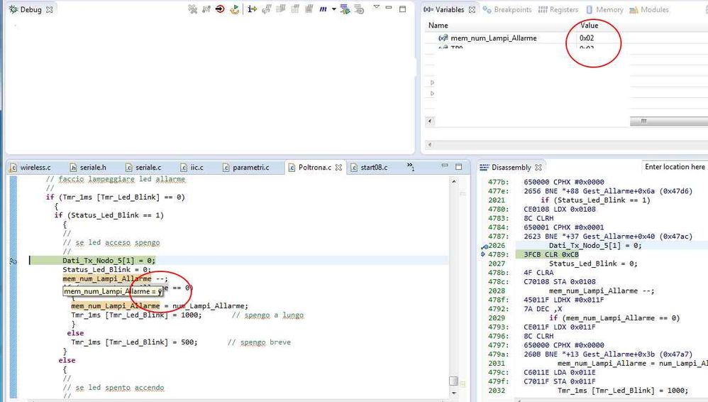

In debug mode, when work with step, when with mouse i go over a variable, i visualize his contents in ascii format.
How can i change the this format ?

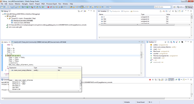

I've tried with Eclipse used on KDS development tool which is base on Kepler.
The problem is solved on this Eclipse version.
Using the same source file I see:
this is the information Erich provided before.

Hi Stefano,
I've created an example based on MCU v10.6 for s08QE128 with simulator.
Attached the example.
With the Pop-up menu through the variable name you can change the format.

This is ok, but i not understud why when with mouse go over variable in the code i look only "y" special 152 ascii character

IlConte
The variable is defined as uint8_t consequently it is a type char
typedef unsigned char uint8_t;
uint8_t mem_num_Lampi_Allarme;
But the "y" is the 152 and don't correspond to the 02 value content
For have a uint8_t viewable how can I change the uint8_t typedef definition ?

trytohelp
Stefano,
The project I sent contains several variable types in the Fibonacci function:
    fib1, fib2, fibo are defined as unsigned int
    i is defined as char
fib1, fib2, fibo are correctly displayed in source file whereas i has same problem.
i is displayed with right value in the variables view but not under main.c
