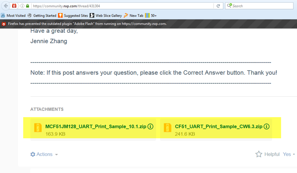

in addition, I ever made printf demo code on 51JM128 demo board with CW10.1 and CW6.3 separately. see attached. hope this helps.

Many thanks for your suggestion, but I couldn't find an attachment. Could you please send them...?

I have uploaded them to this thread, can't you see them?
if it's invisible on your side, please send me your email address, I can send them to via email.

Thanks, I have seen them. It looks like they are set to drive the TXD1 & RXD1 channel. What changes do I need to me to use the TXD2 & RXD2 pins...?
