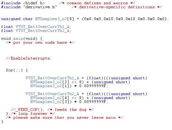

Code:

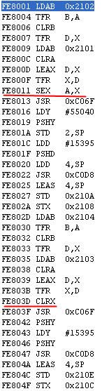

When run this code, VTST_BattOverCurrTh1_A not equal VTST_BattOverCurrTh2_A and get a wrong value
So I view assembly code,
When execute SEX  A,X  JSR  _FUFLOAT, get a wrong value, it seems SEX  A,X  wrong, compiler's bug?

I reproduced your problem. Will escalated it to development team.
for the moment please define HVSamples3_o2 as unsigned short as a workaround:
unsigned short HVSamples3_o2[8] = {0x0,0x0,0x10,0x0,0x10,0x0,0x0,0x0};
thus
both VTST_BattOverCurrTh1_A and VTST_BattOverCurrTh2_A will be 40.95996.

Thanks, it is not the best way to fix this problem, my code generated by Simulink, I can not control all the code. If it is the compiler's bug, hope can fix it fast. It is also exists in CodeWarrior for S12x V5.2, thank you!
