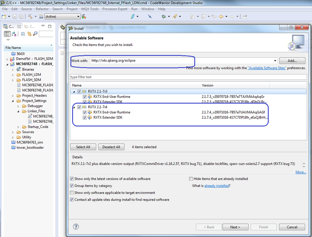

TICS_Fiona
Hi Dhanalakshmi
Please install the RXTX for Eclipse in CodeWarrior IDE from <Help> menu-> Install New Software…, then add Site and install from:    http://rxtx.qbang.org/eclipse/
Does it help?
