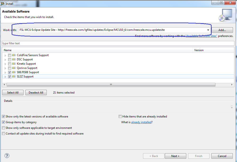

When I start a new project my choices for device types are coldfire and kenetis.  I need to make an S08 project, how do I add this to my installation?

It seems that you only selected Coldfire and Kinetis support packages when installing your CodeWarrior 10.6. Could you please also install the package for S08?
To install a new architecture later, you can use Install New Software and use the online update site. The link for the update site is:
http://freescale.com/lgfiles/updates/Eclipse/MCU10_6/com.freescale.mcu.updatesite
Please see this screenshot.

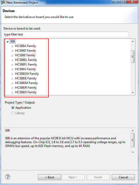

Hello Aaron,
It also like the kinetis , when you create project , please select :
Does this can help you ?
