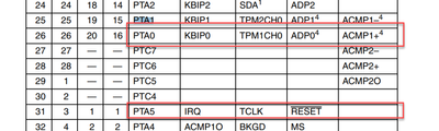

the PTA0 does not have IRQ function, it has KBI
The PTA5 has IRQ, but it does not have KBI
please check the attached
Then if I am understanding properly you can set the IRQ on the PTA5 with the vector interrupt 2
and you can set the KBI on the PTA0 that has the vector interrupt 18
With this you will have 2 vector interrupts, 2 status and control register.
The KBI has a higher priority.
