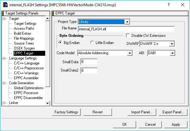

             I am using the codewarrior to develop on MPC5566. I want to generate a static link library for BSP and drivers.Do you know how to generate it by codewarrior? And how to link the static link library when develop the application by codewarrior? Many thanks!

about static library creating, open project settings, click EPPC Target, and change Project Type to Library.

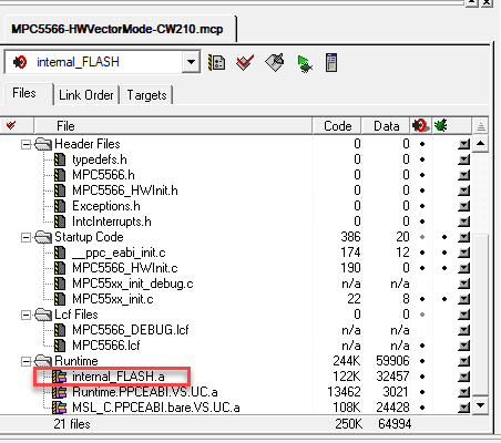

About linking, create you own library as I described above and simply drag and drop this library into Runtime folder of the project you would like to link the library to. Now you can call functions from the library.
Hope this helps.
