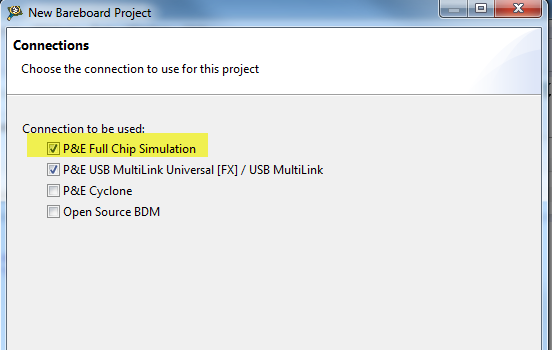

In CW10.7 (S08) is there a simple way to change the debug option from BDM to simulation, or add a simulation option?

Hi Julian.
CW10.7 for HCS08 integrates Full chip simulation, you can select it when you create a new project.
If you already have a project and you want to modify a target to Full chip simulation mode. Please refer attached video.
Hope this helps.
