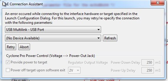

I am using CW10.7/Windows 7 I have a Multilink Universal FX and a S08 demo board and both boards exhibit the same problem. The hardware is recognised by Windows and the device manager shows the devices to be "working properly". when I use the C/W flash feature everything is fine and the device is programmed correctly.
when I try to debug the connection assistant window shows:- pastedImage_1.jpg
but when I retry the window returns with: -
If I disconnect the USB and reconnect the same process repeats itself. This happens with both the Multilink and the demo board.

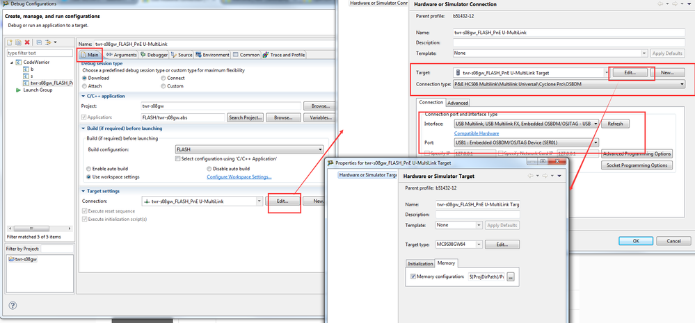

2. If  still can't work, In order to work on your problem , please tell me which demo board,
also please take a video or take screenshots to show the steps and the debug configuration view :
Hope it helps
