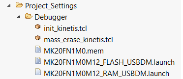

Hi Lisa,
In the standard Codewarrior project the .launch files are located in the Debugger directory.

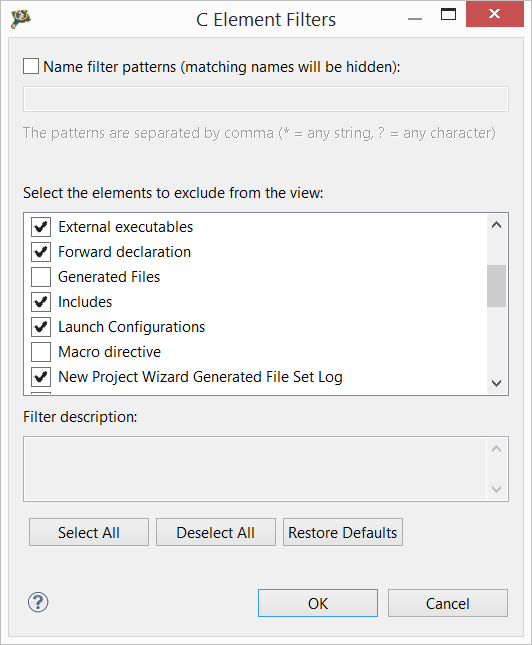

They do not appear in the Codewarrior browser because of the filter settings.
You should be able to save these in a source repository along with the other wiles in this directory (.mem & .tcl)?

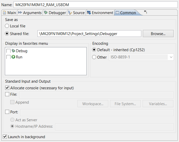

You can create and change where (& if) they are saved as file by changing the settings on the common tab of the launch settings.

lisamichauxsmit
Yes!
Debug Configurations | Common | Shared File
That setting is what I was missing.
